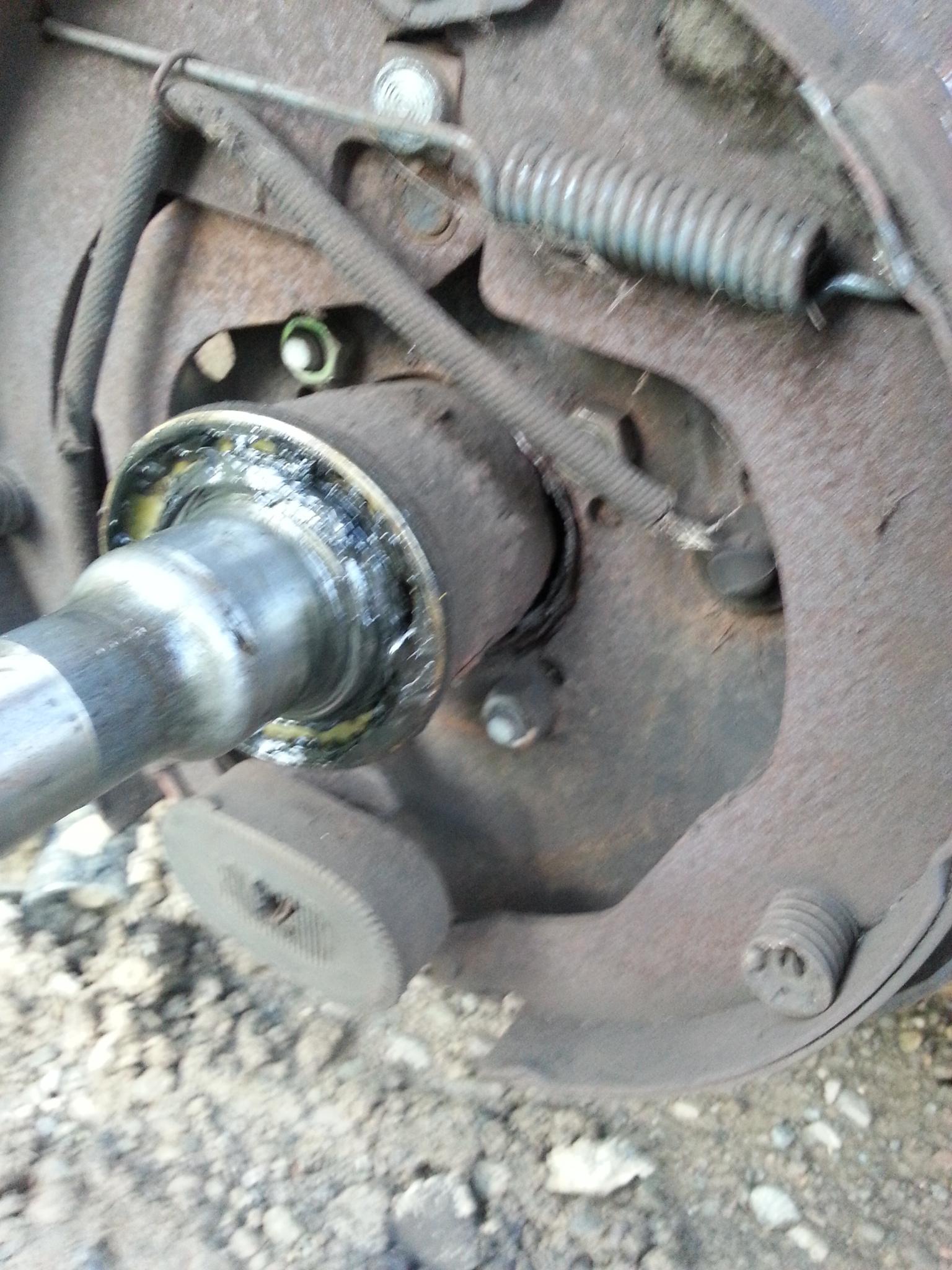

I plan to fix it - problem is, I only have my dads 110v MIG here, and my trailer axle has sprung a leak so to speak.....
