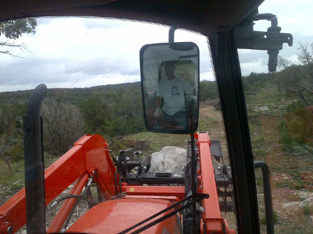

Moved some big rocks over the weekend at our ranch west of San Antonio with our Kubota M8560 and Solesbees 84 inch rock grapple. Tough gear for tough country.
