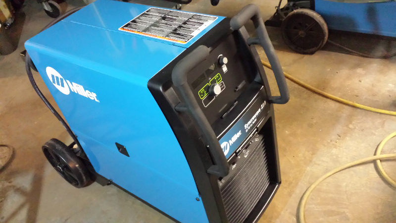

Shieldarc, I just got my first inverter. Gonna play with her after work today! Yahoo! The first one showed up broke and I just got another yesterday. Only played with it a little bit and it got late on me,
but from what I see already me likey!!!!!!

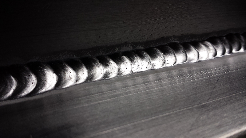

I got a few short welds out of it playing with the settings and it threw itself into dc stick mode and would not come out. It wouldnt even work in dc stick. Miller took immediate excellent care of me tho and sent me a new unit asap. Ill post some weld pics and a report after I tune it to my liking, all I ever ran was transformer machines so it all new to me yet. But I like the way she feels already. I only took one pic so far,I gotta play with the balance I think.
   / Which type of welder would be best for my needs? #43
The Dynasty's were inverters and the Syncrowaves were conventional machines and now they have inverter Syncrowaves. What's up with that?
Had me baffled as well, but it was perfect timing for me. My smaller tranny syncro died on me again, 2nd time in 6mths and my next machine was gonna be a syncro 250. I just wasnt financially ready for that and my lws gave me a smoker of a deal on this guy. Saved me about 3g :) And the cool thing about this one is it only weighs 133lbs. One half of it is a storage compartment.
