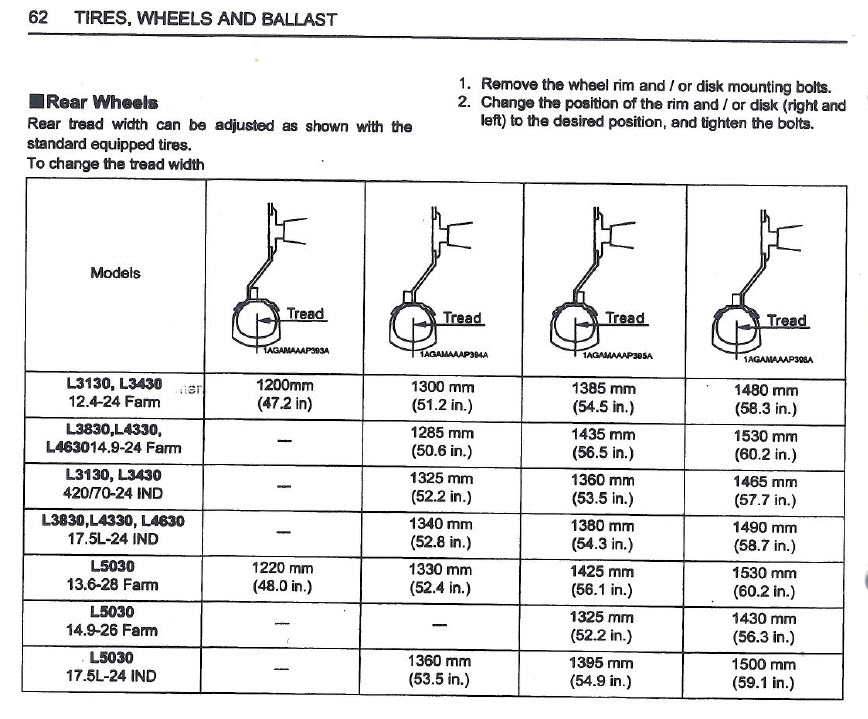

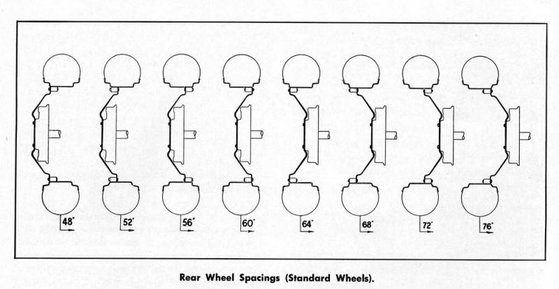

It depends on how the wheel is made. Some wheels can be turned around or swapped side to side with a fixed valve stem. If it has a rim and center disc, you can leave the valve stem on the outside an have several spacing's.
Here are two types.
