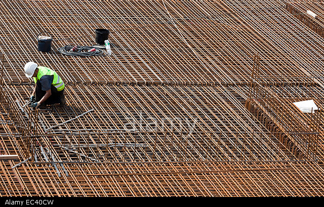

Rebar is bent all day, every day all over the world. Nobody grinds or uses heat (to my knowledge,,,, but I've been wrong before). But you certainly could do that (if there are no construction workers watching), :D
426856d1432829104-will-bend-less-more-rigid-reinforced-concrete-construction-worker-construction
Not sure what you guys are getting at. FTG's project doesn't have any bends where breaking is a remote possibility.
FTG you don't have to go to the store. just straightening up those legs more vertical (where they don't add bending to the support rod) will help a lot. Try just setting that cross support rod on a couple 2x4 stakes (wood) you'll see what I mean.
