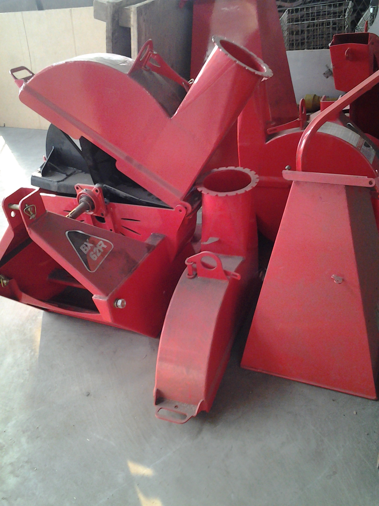

I almost bought a Bearcat chipper. I researched them to death and ended up talking my father into buying the 5540 chipper/shredder for his place. He likes it but I ended up realizing that I wanted a bigger intake chute for the chipper. I liked the one you have but I ended up going with the Wallenstein because I saw it at the New York State Empire Farm Days show and liked its design. I've used my Dad's chipper/shredder and it seems like a quality piece of equipment. I believe Bearcat makes Woods or the vice versa. I think you can't go wrong with either brand, but I did like the fact that Wallenstein painted mine to match the tractor.
   / Which wood chipper to buy? #44
I almost bought a Bearcat chipper. I researched them to death and ended up talking my father into buying the 5540 chipper/shredder for his place. He likes it but I ended up realizing that I wanted a bigger intake chute for the chipper. I liked the one you have but I ended up going with the Wallenstein because I saw it at the New York State Empire Farm Days show and liked its design. I've used my Dad's chipper/shredder and it seems like a quality piece of equipment. I believe Bearcat makes Woods or the vice versa. I think you can't go wrong with either brand, but I did like the fact that Wallenstein painted mine to match the tractor. <img src="http://www.tractorbynet.com/forums/attachment.php?attachmentid=354231"/>
Did you attach those 4x4s to the bottom of your Wallenstein?
A few of us on here have talked about doing that, as the angle of the PTO shaft when the Wallenstein is on the ground is a little too steep for our liking.
   / Which wood chipper to buy? #45
I did. I ripped our old wooden deck out last summer and I had sealed it a few times over the years, so when the posts came out they were already sort of weatherproofed. I cut a couple to length and used lag screws to keep them attached to the chipper. It gets it off the ground just enough because of what you mentioned. I wondered why they didn't make the bottom platform just a little higher for that reason.
   / Which wood chipper to buy? #46
That is great! Nice to see someone who went ahead and did it.
You're right... really odd that they didn't make it lift up a little more.
