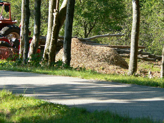

   / Which woodchipper would you buy if you had +/- $2,500 to spend? #8
New is nice, but you can get a lot of chipper for yout money buying used.
There are a couple of things to look at when doing this to be sure you are getting a servicable unit.
I have a valby CH 170 HF and it is a great machine. They are priced stupid high for new, but I bought mine used with but a few hours on it along with a heavy 30" throw, American wood splitter.
I run them both on the back of my L 3710 HST and they match with the tractor perfectly.
In the last 10 years those two pieces have done an enormous amount of work on my orchard.
I serviced the chipper the other day and checked/dressed the knives. After all these years of chipping hard wood and fruit wood trees they looked nearly new.
I am so impressed with this unite, I would recommend a used one in a heart beat.
re a PPI; I would check the input shaft for twisting, the belts for wear and alignment, the rotor bearings and anvil mounts for tightness and the knives for any sign of abuse. A quick half hour of inspection will confirm the unit is solid.
Half price for a valby 140 size chipper would fit your budget and you will have a REAL chipper.
Here is the pile I chipped just last week.
the right most picture is some of last years work........ That thing is a crazy limb eating gobblin!:confused2:
