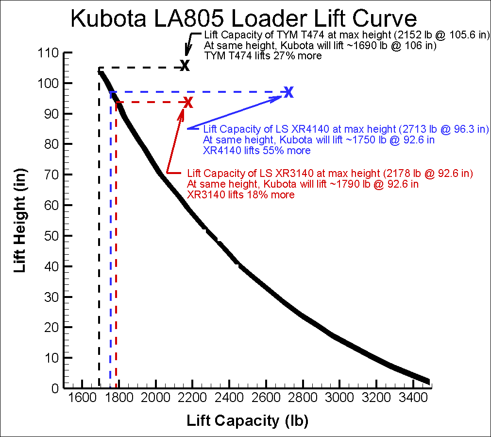

Just curious, why did you feel the the loader was anemic? Are you sure that you idled up?
   / Which would you buy? (Help me spend my money)
#13
I'm just going off the stated load curves, relative to other tractors that weigh the same. The LS XR3140 lifts significantly more, as does the TYM.

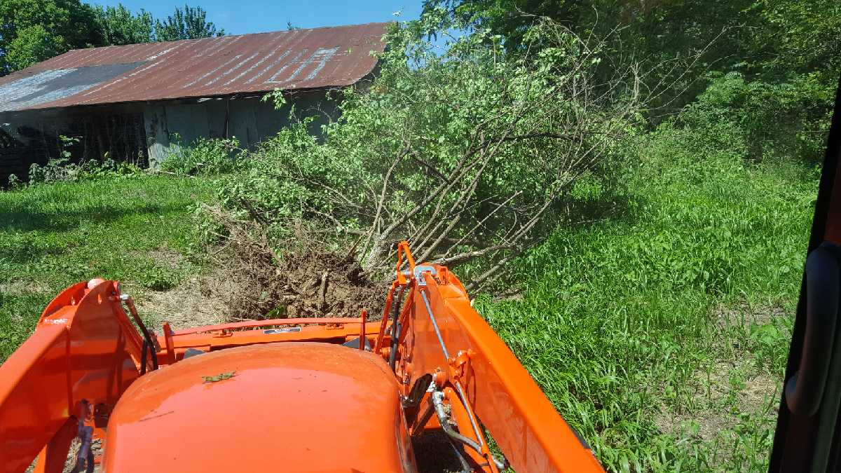

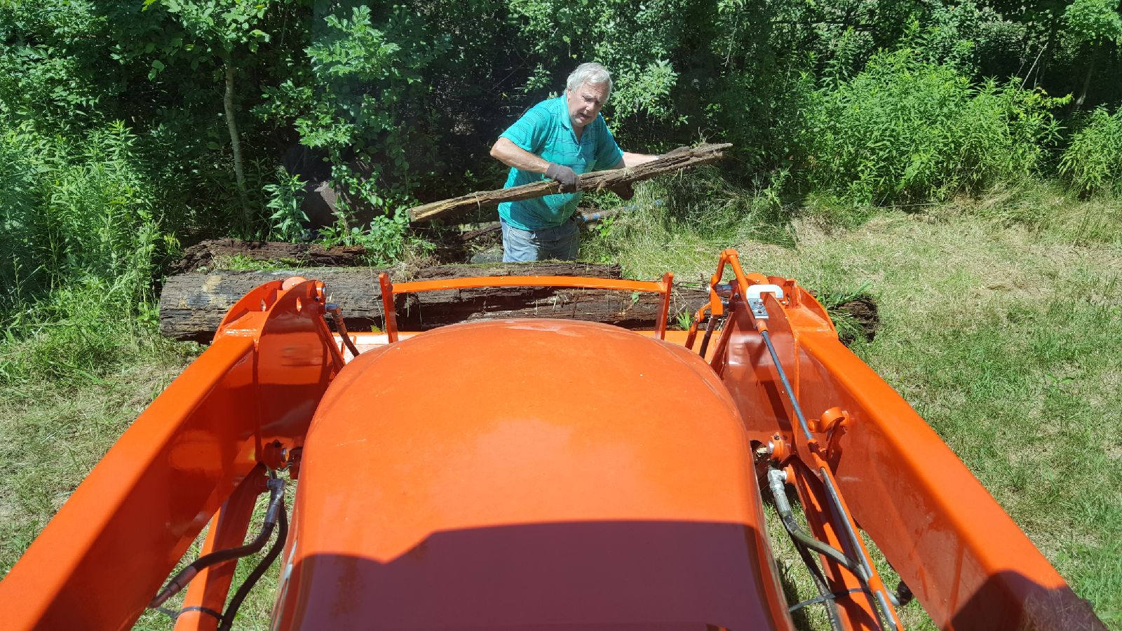

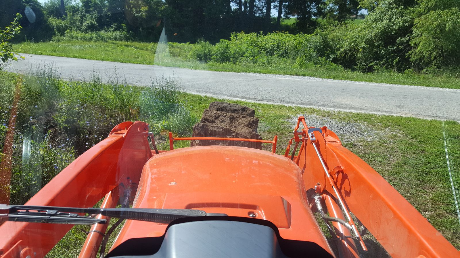

I know which one I would buy, because I purchased the L3560HSTC. I didn't realize how much I would use the Plus transmission. In general, I leave my tractor in Medium and use the Plus to give me the extra boost when I need it.
As far as loader, I haven't had any issues. It has done everything I have wanted to do so far.
Moving dirt
Carrying debris
Dragging a tree with Ken's Bolt on Hooks
Carrying chunks of old concrete foundation
