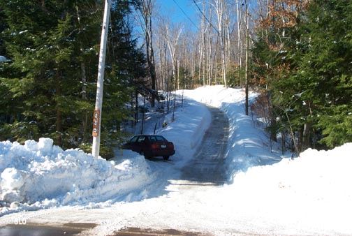

I finally got a chance to practice with the rear blade, I have front chains also. They are simple to put on via the FEL. I dont use spreaders and have no slop or flop either. They are simple roller chains. I was going to buy rears but my dealer told me not too. Fronts are cheaper and easier and he assured me they will work, they do! /forums/images/graemlins/cool.gif
One thing I should mention is to watch the clearance between the hydraulic hoses on the FEL controller and the right front wheel chains when turning hard to the right. Initially y chains contacted the controller hoses and knocked one loose! (what the heck is this clear fluid leaking from my tractor???...geez thats not water!! quick shut it off!!!!) /forums/images/graemlins/shocked.gif
Anyway I adjusted the hose angles and all is well..
My driveway is a 500' slippery icy slope. I was able to back blade up the bank with ocassional diff lock engagement.
good luck
happy in NH /forums/images/graemlins/smile.gif
see slippery slope photo attached

Say, RamEye, looks like you could make an unplanned entry onto the highway with a sled run like that!

Except for loggin rigs..most folks with machines around here (my observation) use just front chains. I originally wanted chains on all 4 tires and the dealer was dead set against that. He felt that would for sure beat up the drive train.
You can see my driveway, it's not trick photography! Usually an icy mess 1-2 inches of ice (covered by snow of course) by the time I get to cleaning it.
Fronts pulled me up the the hill dragging my rear 7' rear blade. So I guess you can take that for face value. /forums/images/graemlins/cool.gif
