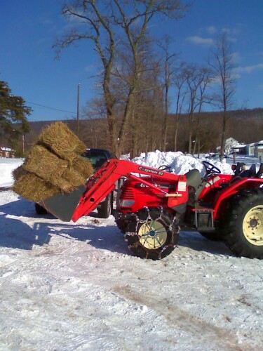

I have used front chains on my 3035 since it was new. Probably put close to 200 hours on it with the chains on. Have had no drivetrain problems at all. These are rear chains from an 8-N ford I dont have any more. Very heavy duty, 3/8's cross chains. Makes a huge difference in forward and steering traction.
