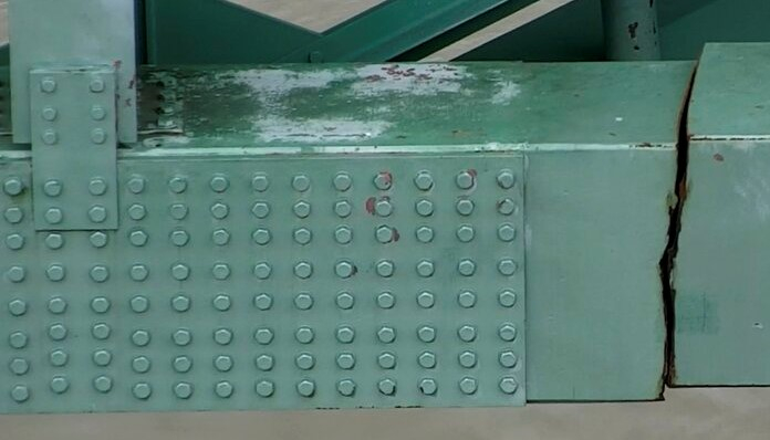

Photos clearly show rivet heads.
That's what I thought until I made the pic bigger, do rivets come in hex shape? (curious not being a smart azz) or is it an optical illusion
   / Who Broke The Bridge? #44
Well color me stupid. I thought rivets too, but no, they are hex head bolts.
   / Who Broke The Bridge? #45
Me stupid also.
But now, are those self tapping?
or is there an access backside to attach nuts not that it matters much as the break is well past those plates.
   / Who Broke The Bridge? #47
I'm somewhat surprised the fracture occurred past the last row of bolts.
I'd have thought that 8 holes in a row (bolt pattern) would have created a fracture path.
Interesting!
But WOW, what stresses to create a near clean fracture in a 24" X 30" box beam.
As I said, must have sounded like a sonic boom from a jet breaking the sound barrier., especially with that long 24 x 36 sound tube.

Like I said it's going to be interesting...right now there are so few facts and so much speculation it's funny...!
Samples once taken and examined and tested etc could show a defect in the metal itself when the steel was made or the mill that made the components...nothing to do with the actual application...
   / Who Broke The Bridge? #49
The articles are blaming the center of the M as a flex point. Will be interesting to see if that is really the cause.
If so, quite a few bridges will need to be more thoroughly checked.
