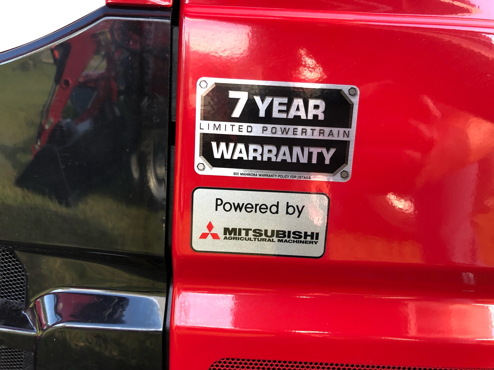

Mahindra have so many models and some are light and have 24 inch rears, I want 26inch and 4000 lbs. Not sure a hydrostatic 45 hp with 24's will handle a 6 ft HD rotary mower and 2 bottom 16" plows. My budget is $35-40K (delivered) max!
Mahindra is joined to the hip with Mitsubishi. And the CEO of Mitsubishi heads up Mahindra!

Mahindra tractors are moving towards being Mitsubishi powered.
