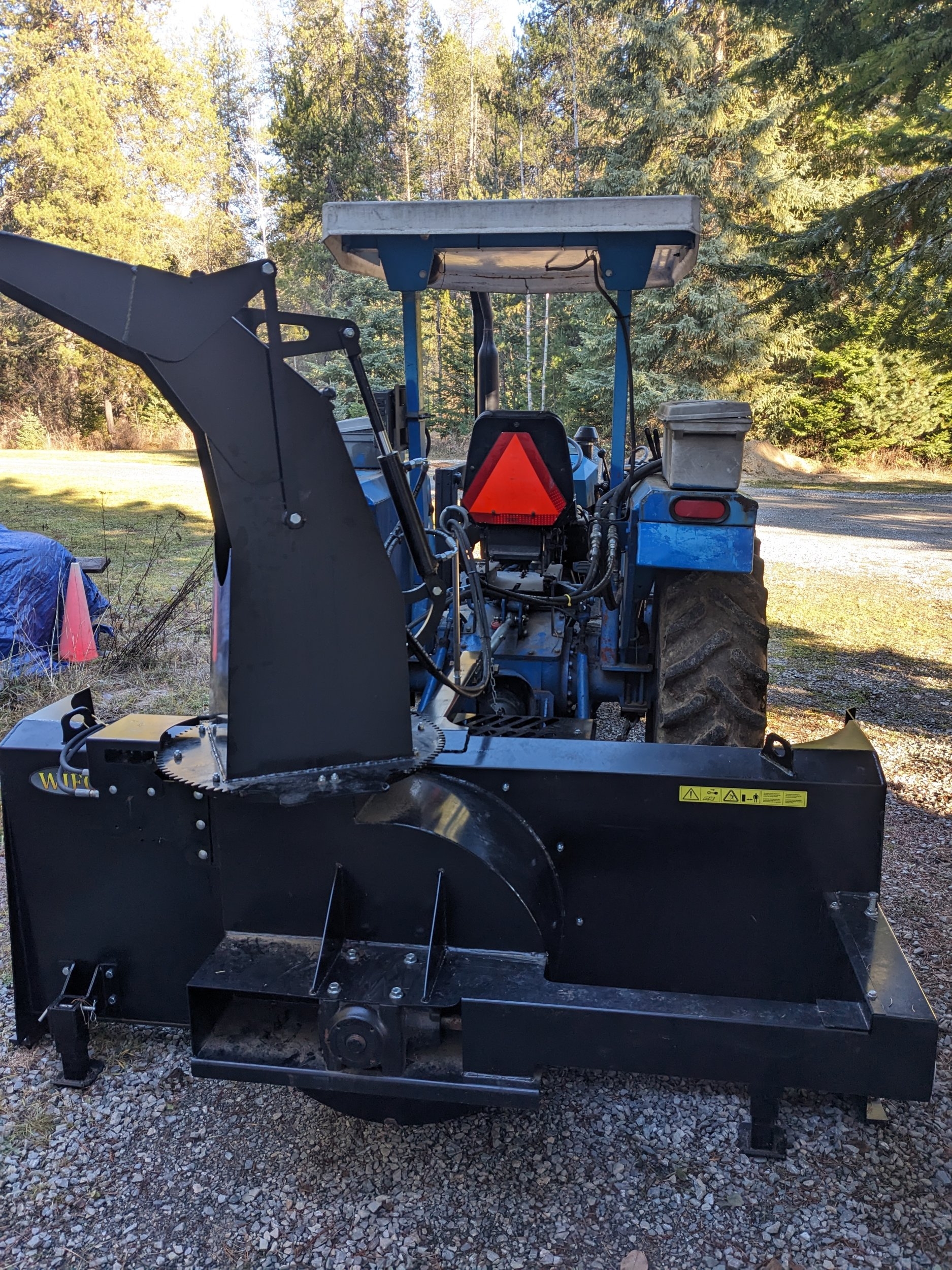

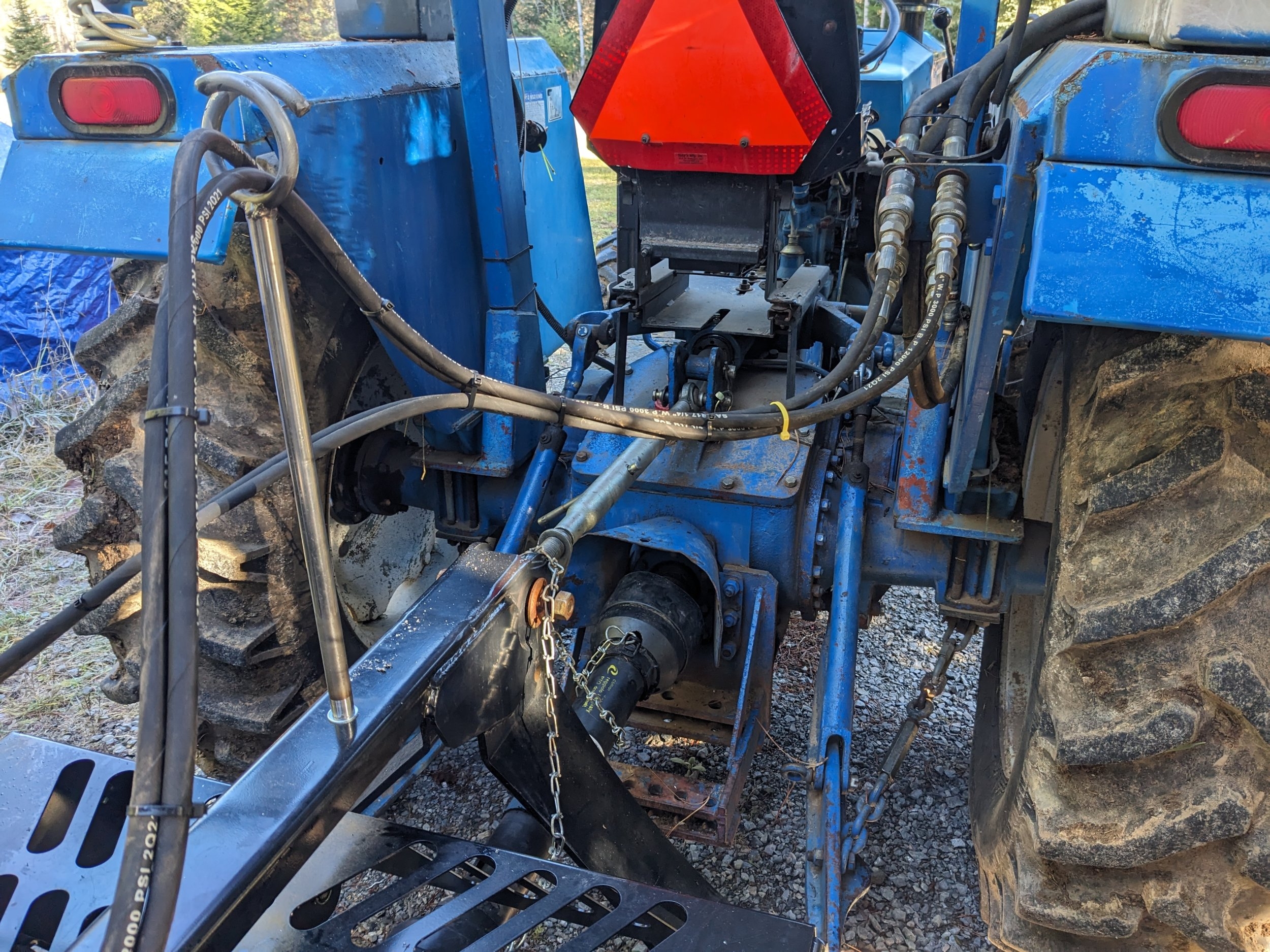

Finally hitched up the Up Shot Inverted blower/
Greased everything, and checked tensioner and reset the rotator gear clearance.
Made a guide support for the chute deflector, so that the hydraulic lines stay clear of the gears when the chute is rotated.
Fun job used the MIG to weld a 3/8" bolt in tube and then turned the flat on my repowered lathe. Then welded a left over piece of my shortened QA springs from the 455 RX7 as an easy guide , (knew that spring end would come in handy for something how many times I almost threw it out).
Just need some black paint.
Next is an oil and Filter change.
ps. Really Like how heavy and well built this Wifo is, even if it isn't the newest style hybrid Inverted, If it works as well as last year there won't be any complaints.

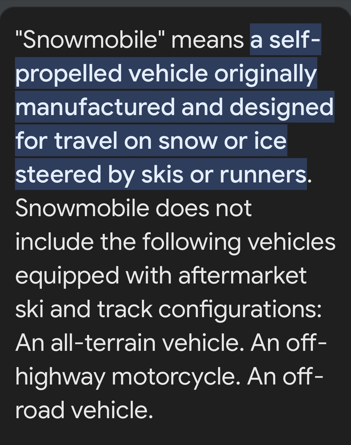

I believe this means for summer used.. .Its a No in Minnesota, No in New York, No in Wisconsin, and no in Michigan... if they are called snowmobile trails the chances is it's no ... and that even go for snow bike. (dirt bike with ski and tracks) ho and no for all of Canada.
   / Who is excited for snow season? Not us! We're depressed due to lack of snow. #265
sounds like the only States track utv atv and snow bike are accepted on the trails is Montana, Wyoming, and Idaho.
   / Who is excited for snow season? Not us! We're depressed due to lack of snow. #266
Correct. I have checked with the DNR here in Minnesota and was shown the definition.

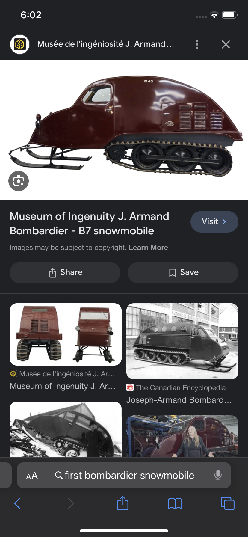

can you imagine showing up with one of these lol … hey it fit the definition
Skidoo made the elite sxs snowmobile model in the 70s- early 80s then tried again in the early 2000s they were wider and a lot heavier than conventional snowmobiles. Never had any desire to own one. ATVs rut up snowmobile trails and aren't the safest going at reasonable speeds on a winter trail imo.
