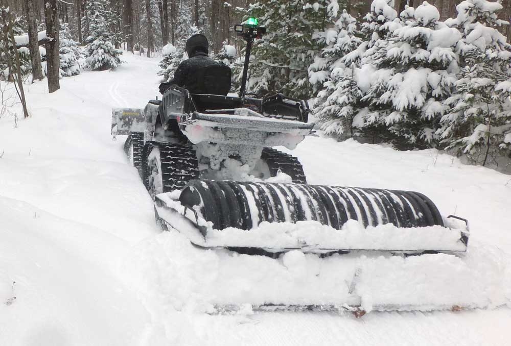

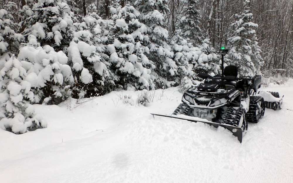

On our trails today. The lake has tuned on and we might have seen 2 feet in the last 48 hours. No not lots, but i least could start rolling snow in my blade. Gosh its nice to have some real snow depth.
Photos by wife cam.

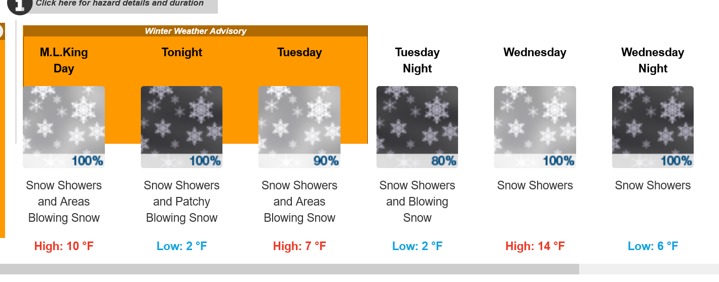

We got rain...
Actually supposed to snow 2-3" tonight, so I am sure everyone will panic :cool:

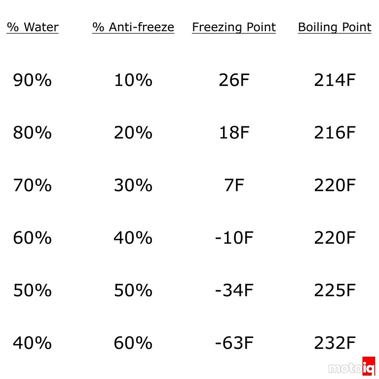

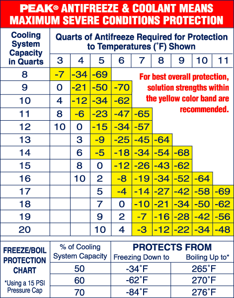

I have always shot for 60/40 which gives about the maximum protection.
60% antifreeze and 40%water, I have heard that 70% antifreeze is better but I don't recall that amount being on the bottle charts.
Well I did find a chart for 70% antifreeze;
   / Who is excited for snow season? Not us! We're depressed due to lack of snow. #638
I never go over 50/50. I had a radiator freeze up on 60/40 before in montana -60°.
mechanic told me never go over 50/50.
but looking at your chart, now I’m confused.

I've always been told maximum freeze protection is 2/3rds coolant-1/3rd water.
However,the heat transfer ability of the coolant decreases as the percentage of AF/water increases.

I wonder if changes in anti-freeze formulas are behind the confusing labels these days. As a kid in a garage decades ago, I vividly remember the anti-freeze mix ratio of 50-50 as the optimum protection and read the chart many, many times.
The only thing that could have changed between then and now is product formulation?
