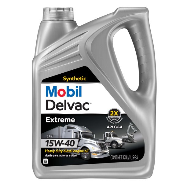

Friend of mine works for a large industrial manufacturing engineering plant and they are REALLY pushing this as a far better synthetic oil for diesels. To the point of 250 hrs. Myself, I won't be changing the intervals, 100 hrs is plenty, but will run it as better is better. Period. Haven't done it yet as I am waiting for a snow blowing job to get it hot. Will also take a sample the next 2 times to send it to Blackstone for analysis. Should I send one of the conventional oil this time or wait until I compare synthetic to synthetic. Have no issues at 1000 hrs, just curious. View attachment 726149View attachment 726149
MUCH too heavy for winter time. Use a 10w40 or 5w40 or 0w40 or even 10w30 or 5w30 or 0w30. ALL are better than this goo to start your engine in the winter. Cranking speeds will be 60-80% faster on any of these other oils vs. 15w40. Almost all owners manuals approve either 15w40 or 10w30. That means these others I listed are even better. Kubota even approves 20w, but you'll not find any diesel oils in 20w.

Pour point is minus 33 C, which is minus 27 F.
So oil pump point is about minus 7 F.
This also means that is oil is very thick, and still resistance to pumping.
North Dakota winters....use a good 5w-40 diesel oil.
