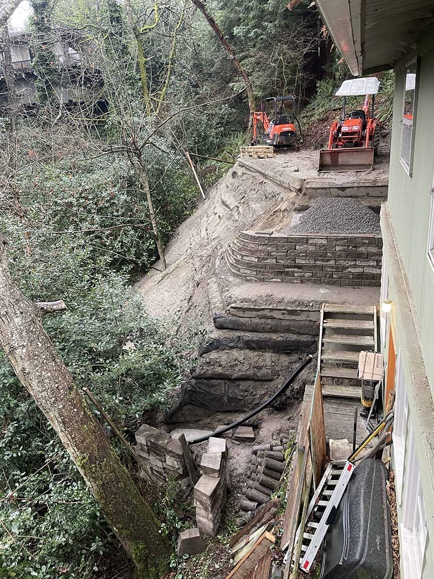

OK, it's hard enough for me to re-read the whole 10 pages myself.
lilranch.....i consider this a discussion, argument has not entered my mind.
ideas, solutions come from discussion.
....I'll recap some of your concerns.
Tree removal is recommended.
I've wanted to take them out before the wall was even an idea.
I got a bid 7 years ago, $5,000 and $2000. So 2025 will be...... what, $8,000 and $3000?
I'll take the trees out later, if ever........or let someone else do it.
Would have been nice if someone did it 30 years ago when it was easy, before all the tree protection laws etc.
I have free-draining gravel behind the wall, from bottom to the top row.
My wall-builders said it was required too.
I put a 1.25 pipe in clean gravel at the bottom, with its slots on the bottom.
Wall builders rotated it to slots on top. It's buried now.
The water has to be one inch deep to get into the pipe, but water that gets in..... drains all the way to the outlet,
Rather than charging up the ground a foot downstream of its entry point.
There are pluses/minuses to each configuration.
I don't see one inch as a wall-killer.
12 inches up (per the diagram) there is a 3" corrugated pipe (in clean gravel) that's perforated on the bottom (and all around).
It would have been nice to put geotextile tails coming out from between my lifts,
to clamp between the block rows as tiebacks
But that's 20/20 hindsight, not possible to re-do.
And unnecessary per block mfr recommendations, 7 rows, 42" high can be free-stack.
I'm real happy with the upper wall.
I'm "hopeful" that the geotextile layup is self-compacted enough, because it's "sand".
It's creating "level land" where it was un-usable slope.
This is just for parking a car and a little yard, it's not a building site.
The lower wall is only 8 feet long but it's 4 rows higher than mfr recommendations for free-standing (11 rows, 66 inches).
Here, some geo-textile tails would've been useful.
A lot of my land has been been leveled over the years. It's steep.
In one area that I was digging in some fill I found lots of rebar, concrete rubble in the fill-dirt. The garage was built in 1978 (47 years), which suggests the fill was done around then. The buried rebar (in fill-dirt) was rusty, but #5 was still solid. #3s were getting down to about #2 ;-) .
Other areas, I dig into the original sand (on the steep slope) and just a foot down or so, the sand is dry even in the winter.
Anyway I have some examples of underground steel onsite, that I think are usable to assume underground lifetime.
I bet they last almost forever in sand - if the sand drains.
I'm hoping to lock tiebacks into sand though.
Steel doesn't lock into sand like it does in soil.
Plusses/minuses....sand requires a deadman...but sand doesn't rust the steel so bad.
I see some challenges that would be nice to discuss with others who have seen similar.
I do appreciate the critical thought, it keeps me on my toes.
Some things could be better but I don't see imminent failure.
I currently need ideas for tieback methods - that can be done before wed Feb12.

This thread started with what at first looked to be a simple problem, but one of the last photos shows a very complicated and large project that is very far along. In a perfect world, the drain and tie backs would have been installed in courses as the base was built up.
I'm the one who mentioned helical ties, but I have strong reservations that they are the solution at this stage of completion of the project. I just don't know what else to suggest to try to salvage this situation.

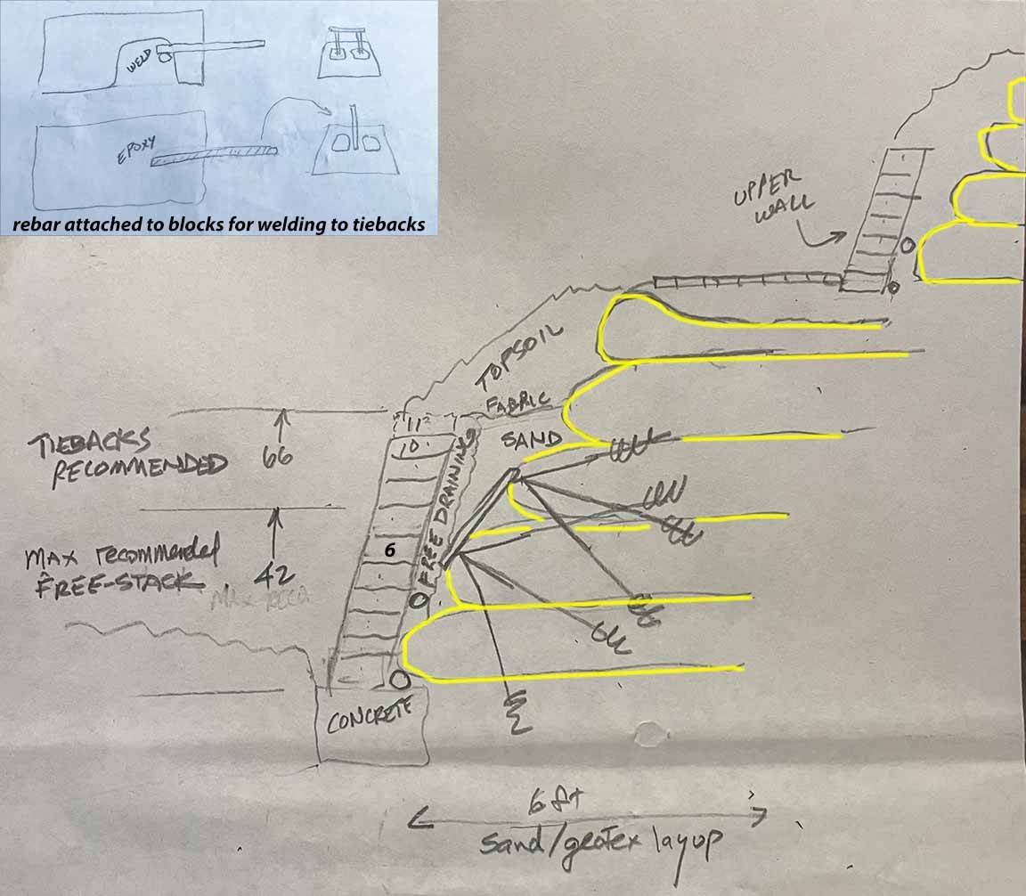

   / Who knows about stacked-block retaining walls?
#100
Can you put layers of geotextile behind your taller wall. Attach that to your anchors. If not put anchor in block with large washer to distribute load
The 11th block will be 3ft from the geotextile lift. I don't think my geotex fabric will do 'much' in 3 feet. The hard plastic type would be better for this, I think ___IF____ it was soil. But the backfill will be sand then gravel.
My current plan, is to have 3 "weldable" blocks on row 6
and 3 more on row 10.
Then weld 5/8 rebar 'ties' from row 6&10...
to the (steel) tieback structure (proposal) which is a welded rebar rectangle frame.
Welding the ties from the blocks to the frame structure, before the backfill.
Unless someone has a better idea.
Understood it's difficult to fully get into "someone else's project".
I do have a couple creative friends who can do this, but they're preoccupied currently.
Wall builders return on Wed Feb12.
Haven't done anything on this yet, other than ordered 12 helical ties, which I don't know at this point, untested (by me) if they are going to "satisfy". I will need to extend them, to drive in much deeper than their 18 inches, more like 3 feet. They are thin steel, how long can they last? If they were coated thick with zinc..... that would help but I bet they're not. I bet they last only 10 years, and with luck, 20. And hope is they lock into the sand (which was not mechanically compacted) that has umpteen tons of sand pressure from above. I'm not real happy with them either, except that they hold things together as the whole pile settles. Thoughts and prayers.....
