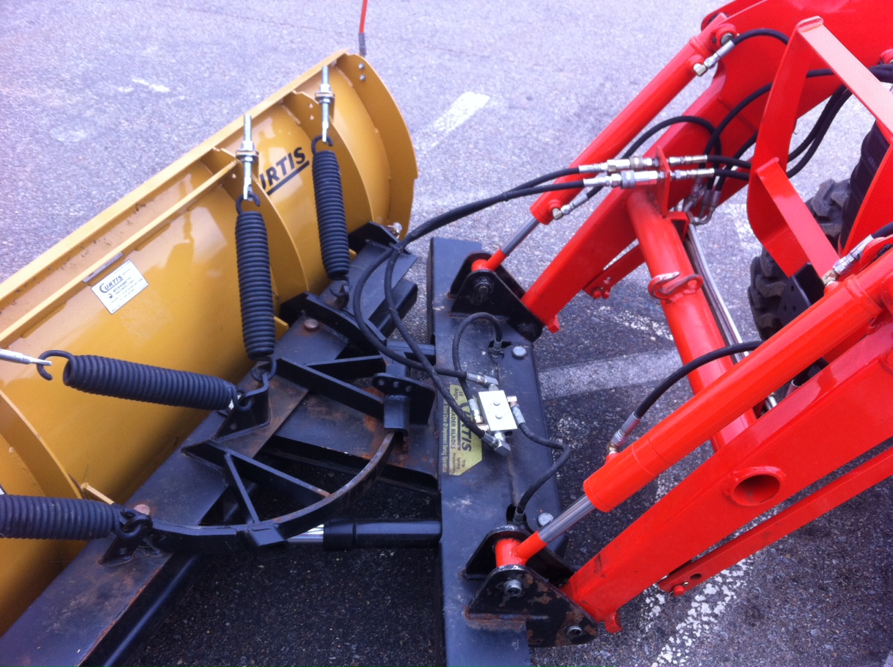

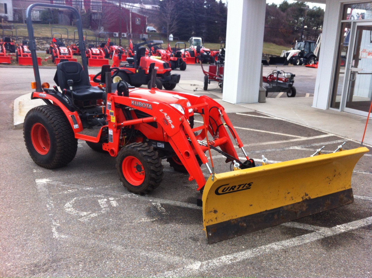

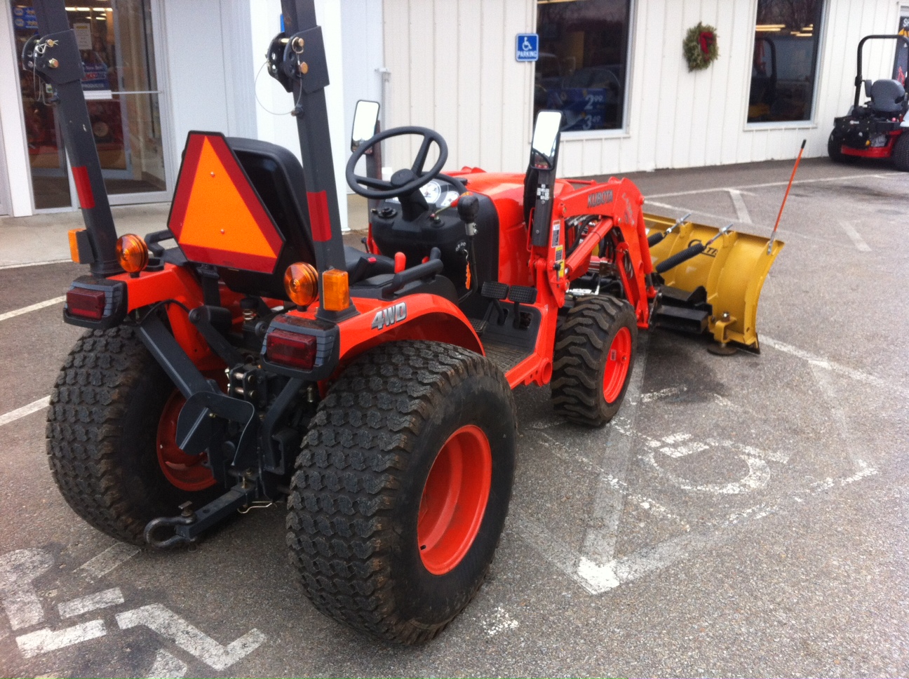

The nicest setup I've seen was from Curtis that replaces the bucket assembly entirely, but still hooks up to the loader arms. While the particular plow that I saw in person wasn't on a BX (it was on a B2620 that was for sale at my local dealer), I don't see why it couldn't have been built to fit on a BX series.
Also since the blade has full hydraulic angle adjust capabilities, the tractor had 3rd function hydraulics installed on it as well. Very nice and heavy duty unit though.. I definitely wouldn't mind owning it as it would work great with my loader quick-attach! :)

I own one of these, set up for my B2410. Great blade but WAY too heavy for a BX to handle, even in smaller sizes.
The other challenge is that there is no left to right pivot, so the path you plow is eneven and the skid shoes must be set up to provide alot of compensation.

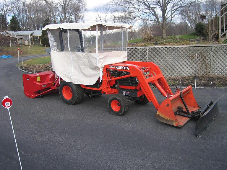

These pictures show the ATV plow I modified to mount into the bucket. The blade will float until you tilt the bucket to hit the upright support for downforce on the plow.
