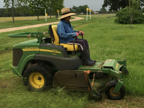

It may be too big for your wish list, but 15 years ago the wife and I bought a barely used JD 997 ZT. Drove 400 miles to pick it up. It has a 72" deck, but I believe some came with smaller decks. 34hp (I believe) diesel. The wife, main driver, has put 1,400 hours on it. Absolutely NO complaints. Only fuel, regular maintenance, and replacement of a few generic bearings. It is a beast in terms of power and reliability and is often used by commercial operators. The thing we like the most is the clean and consistent deck flow and cutting quality. Deck is nearly indestructible, too. There may be gas versions still available, but the diesel version was discontinued years ago, I think it may have been EPA air regulations or the weight class (1800#) and changing safety regulations that killed the diesel.

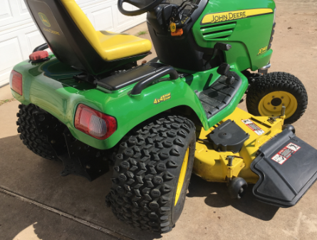

On the contrary, just to confirm that all JD are not the same, we once owned a JD X749. Diesel 4x4 w/ all wheel steering and a 60" deck. The desire was something that had better traction that a ZT on soft ground and around the pond perimeter. What a huge disappointment - but only in the deck. The "tractor" portion was excellent, but the deck design was s**t. It was almost incapable of mowing anything more than 1" of grass per pass. The design flaws were bulges and obstacles under the deck that interrupted the air and material flow. Happy was the day the X749 was sold. Still have and use the 997 ZT, and appreciate it every time it is used.

JD X749:
JD 997:

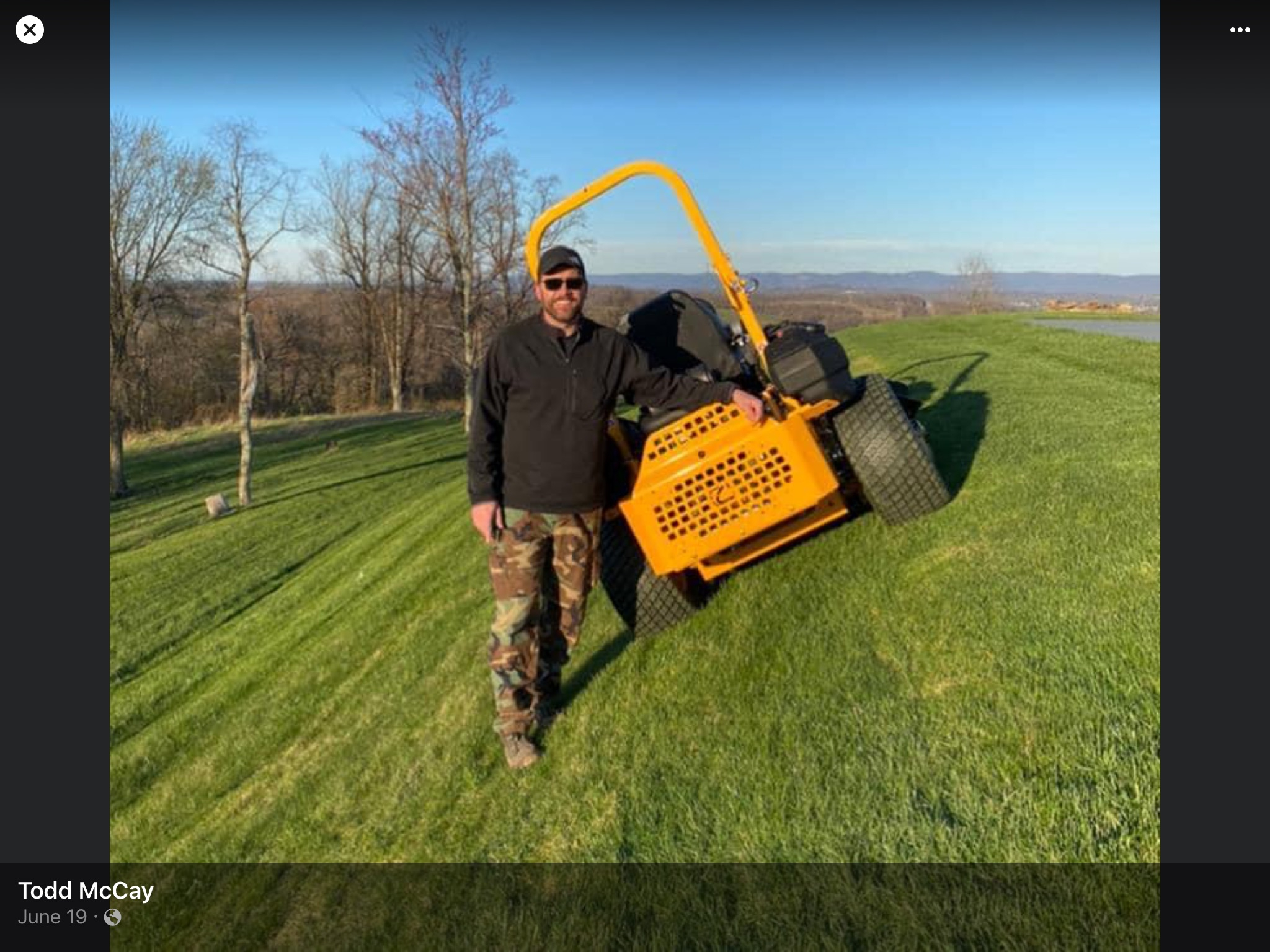

"So who makes a good diesel zero-turn that will last forever...." THEY DON't make a varmint like that. Second - why do you want the additional cost of a diesel? Most mowers the deck or drivetrain wears out before motor does. (Look at Cub Cadet with steering wheel rated better tan any zero turn on a hill.)
