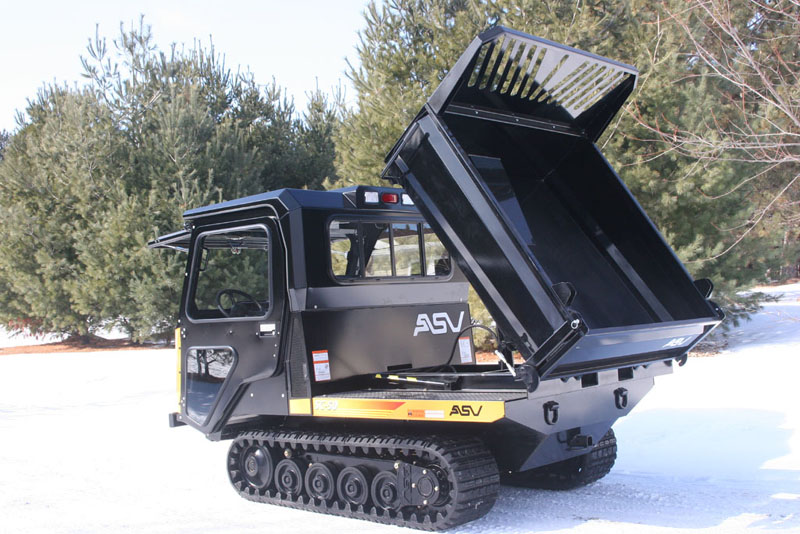

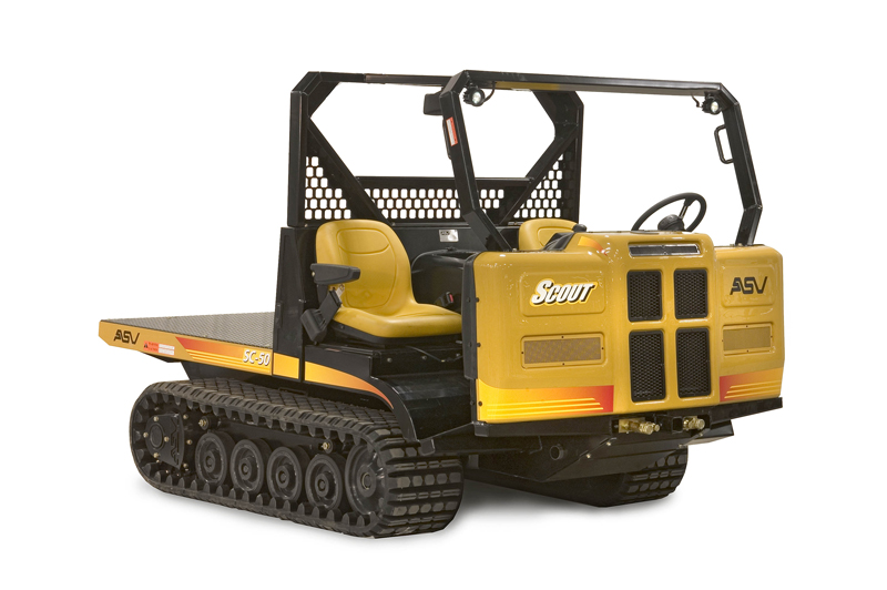

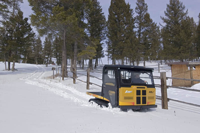

pekabu said:
Does it have to have wheels? The ASV Scout SC-50
If you want to do REAL WORK, carry 2 tons of payload (yes, I said 4000#), have something that is stable, easy to drive, and durable then look at the ASV Scout. I have not driven one, but I know an engineer who does work for ASV and he is very high on this vehicle. After talking with him, so am I. It is a true work vehicle. This is not a trail running toy with a 500 to 700 pound payload capacity.
Perkins 50HP diesel for plenty of power and your choice of the various ASV tracks that give under 2.5 psi so soil compaction is not an issue.
Prices run $25K to $35K
You can get a cab or not, you can also get hydraulic remotes front and/or rear.
He told me they started their production runs this past week.
Link to specs. Scout SC-50 Specifications
A couple photos below are from the ASV Scout page, he took the other two of test vehicles in the Minnesota snow last week.
