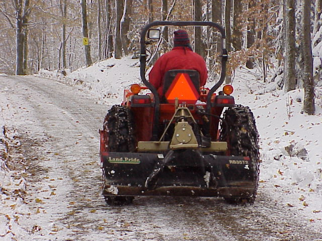

I have chains on my B7500. I don't have a problem with clearance with my R4's, so you should be find with yours.
I bought chains after the first year on my property; have a very rough unpaved driveway. After I bought the chains, I paved the driveway, so the chains are not as necessary anymore. I do still stick them on though.
Will try to attach a picture; doesn't always seem to work.
Good luck.

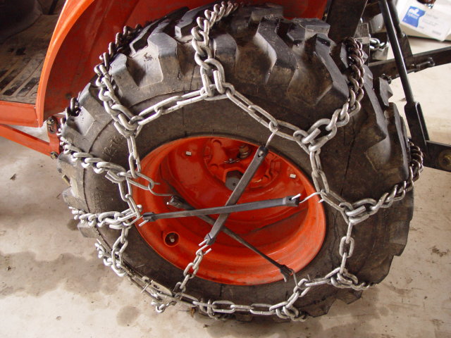

Or you could go with the gnarly Norse ice chains and rip up the turf wherever you go!
Pete
