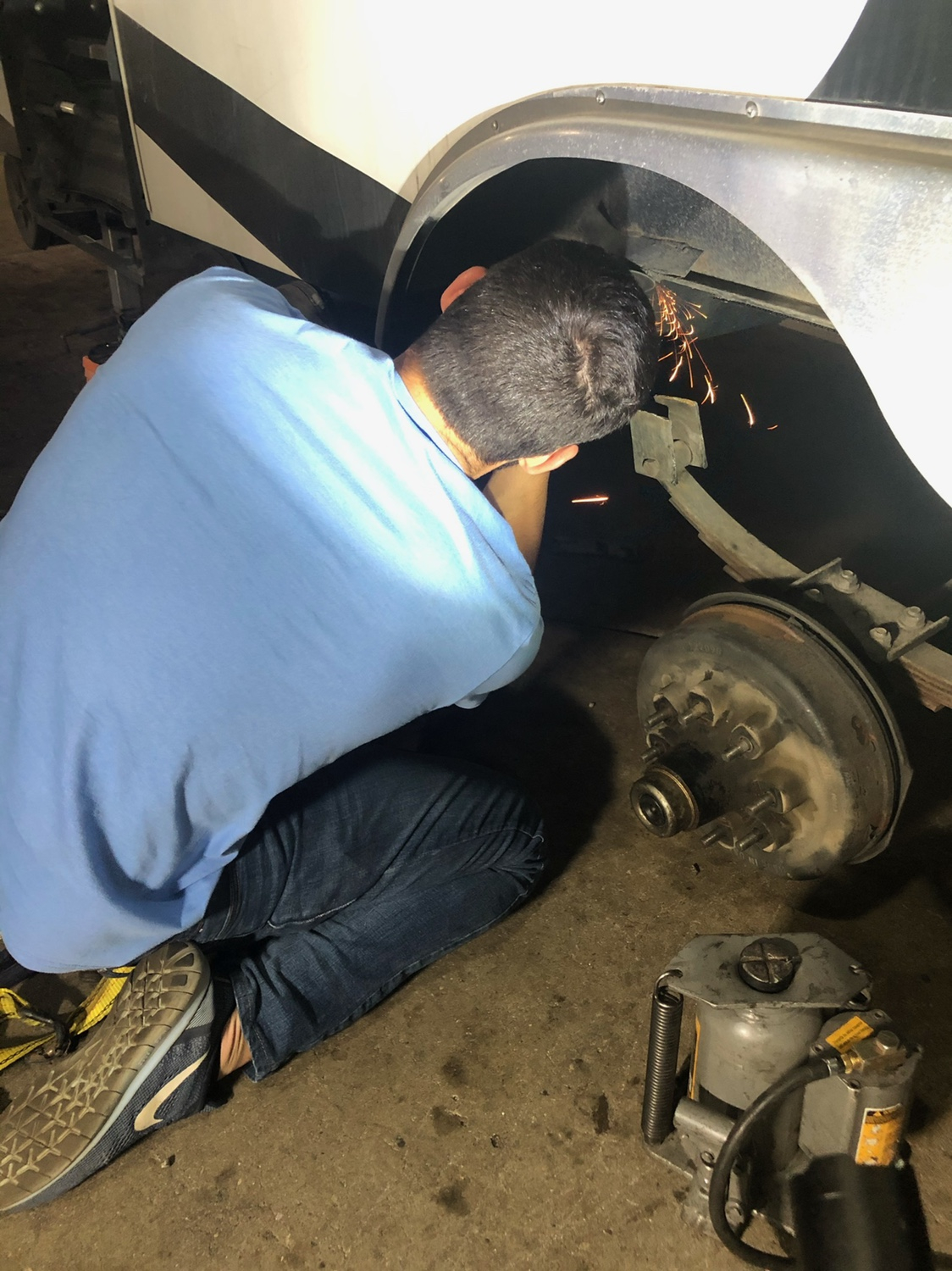

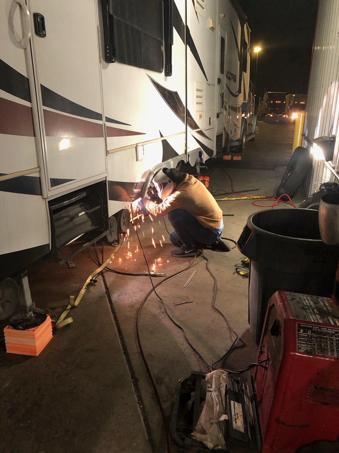

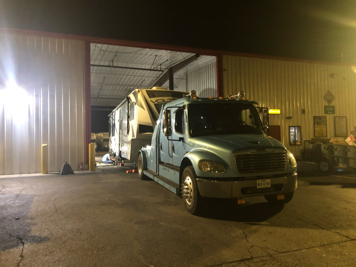

About 1am at a Loves truck stop, noticed while fueling up. On the road for about 20hrs at this point. I wasn’t happy.
Cool the Loves guys let us use their tools and bay though!!
   / Who owns a triple 7k axle equipped trailer? #14
Nuff said? I want to hear what happened!!
