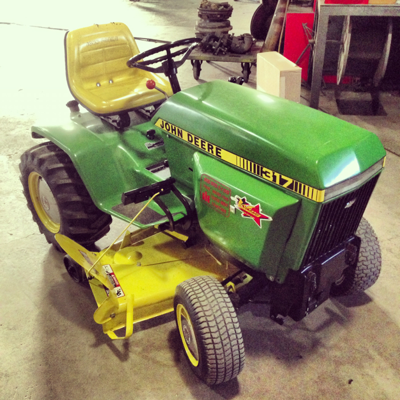

I just started using a 79 317, not my choice over an 04 345 hahaha

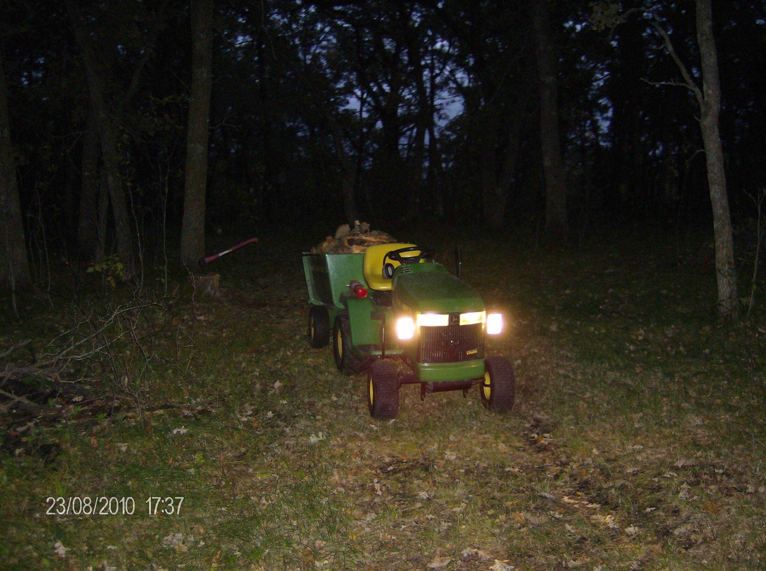

The LX188 was over-built back then with a K61 Tuff-Torque transmission, with 3/4" instead of 1/2" lightweight spindles on the L, LA, and D series lightweight tractors nowadays.
The torque is equivalent to the K58 tranny (200 ft. pounds) torque on todays X320 through X360 tractors.
As far as heavy towing, though, you're right. I can tow a 25 gallon sprayer uphill, but it is really straining.
Luckily, I have a downhill run with a cart full of firewood on the way back to the house. I REALLY need to replace it with an X500 with over 400 pounds of torque with the foot peal that can lock the rear wheels together.
This little "bull dog" mows all my fire trails in the woods out back, as well as the yard.
