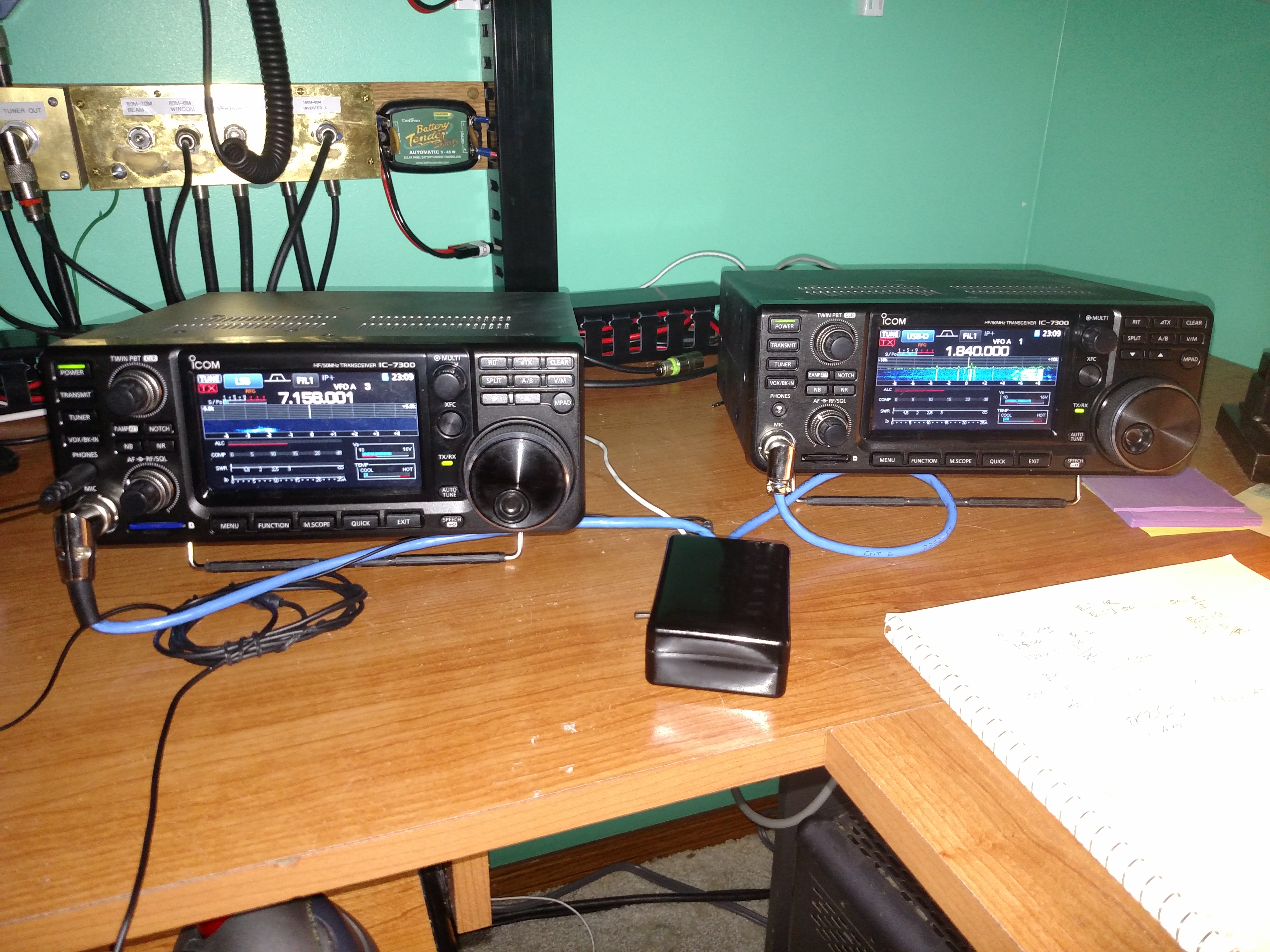

Moss, here are the "twins" I referenced in the PM I just sent you. I did finally get the guy in Belarus in the log.
Still listening to the guy in Kuwait. YOu can see the frequencies on the display.
