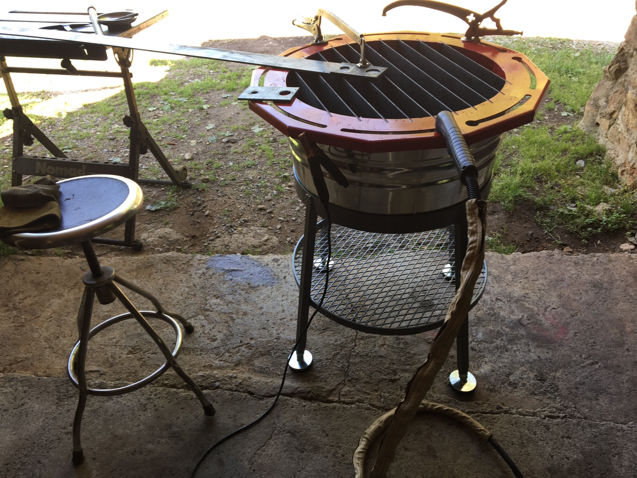

911 Motorsports makes a handy tub table and stencils for accurate hand cuts. Dry captures about 75% of smoke and all the dross. Wet almost 100%.
