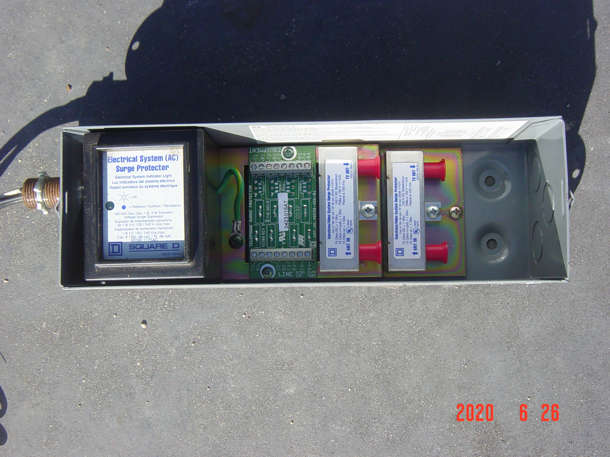

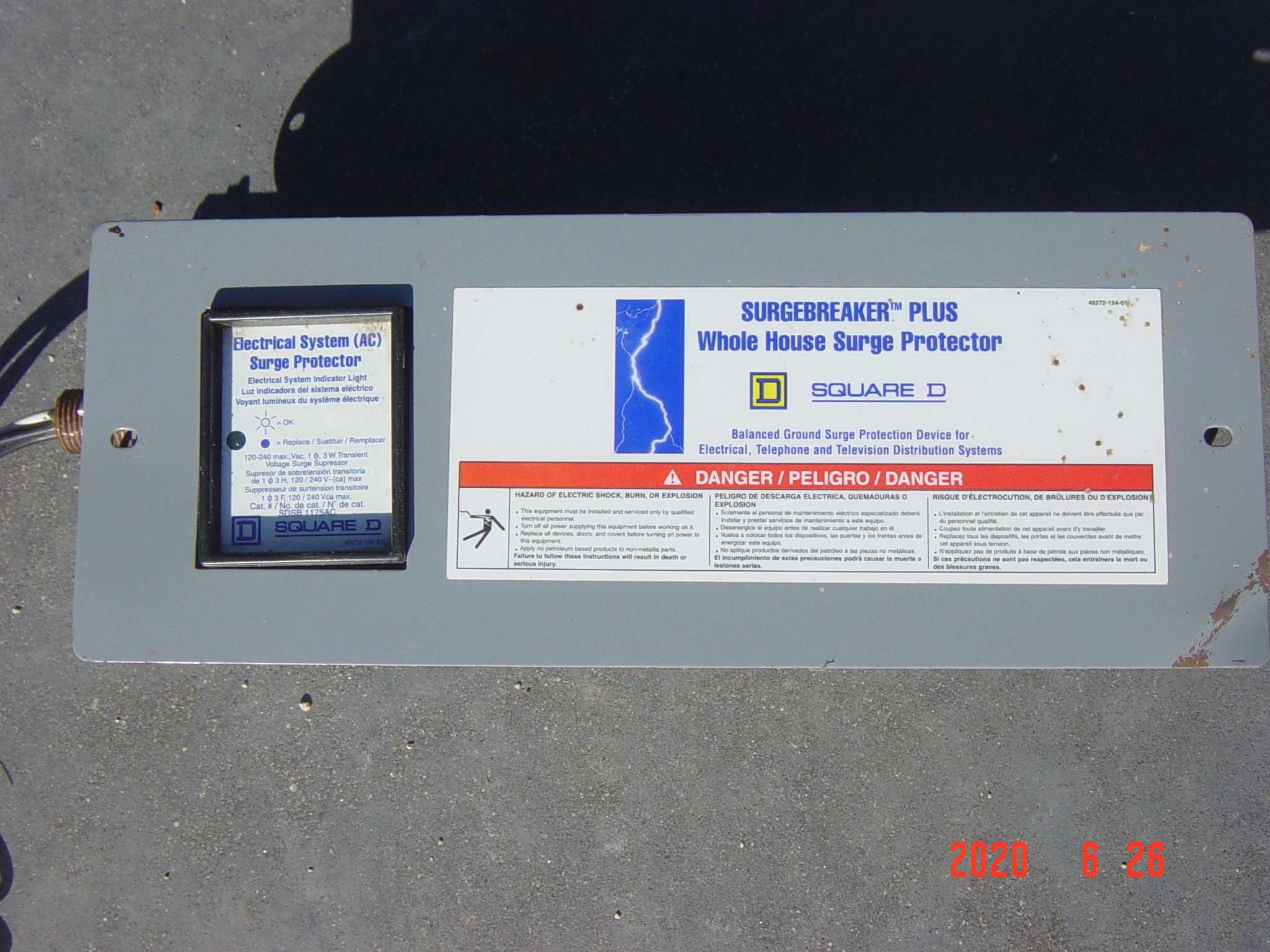

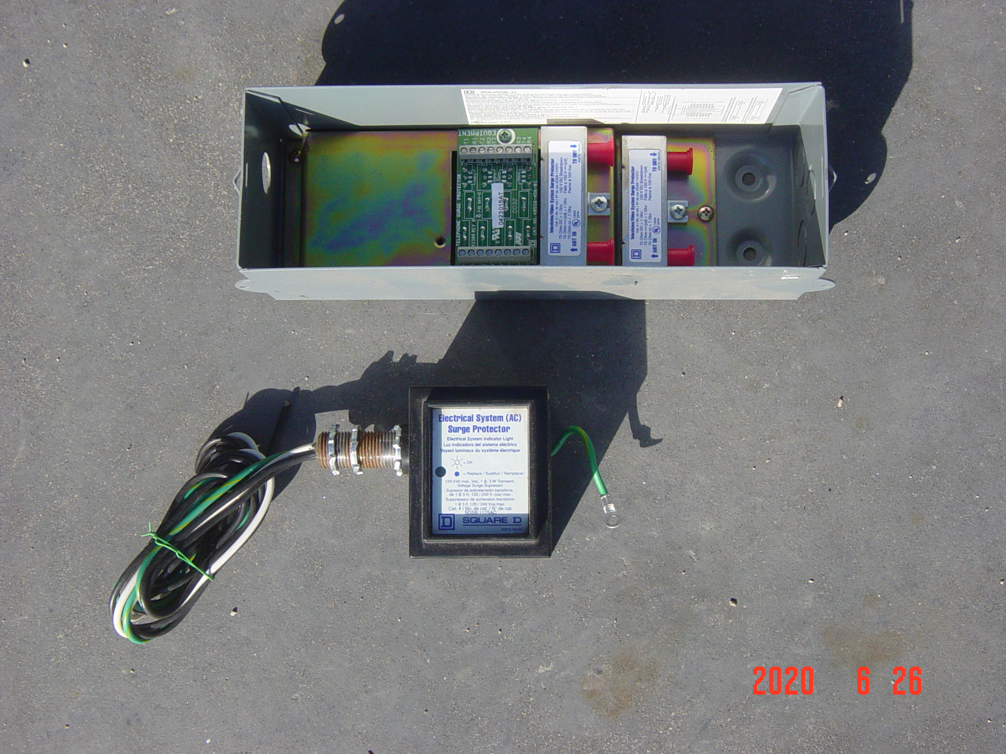

The thread got me thinking and I spotted the surge suppressor while cleaning my shop today.
So Bob's your Uncle, smaller footprint, I didn't need the Telco or COax protection and now it should be installed in a year or two.

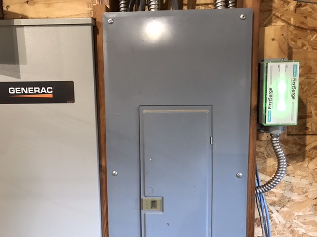

I have a Siemens FS140 on my shop and one on the house. Each is a 200 amp feed off of a 400 amp service. Ive sold and installed many of the Siemens FS140痴 over-the years. There is also a flush mount kit available if your panel is in a drywall壇 environment.
funny thing is Amazons crazy pricing has the fs140 cheaper than the fs100 and its a far better unit.
