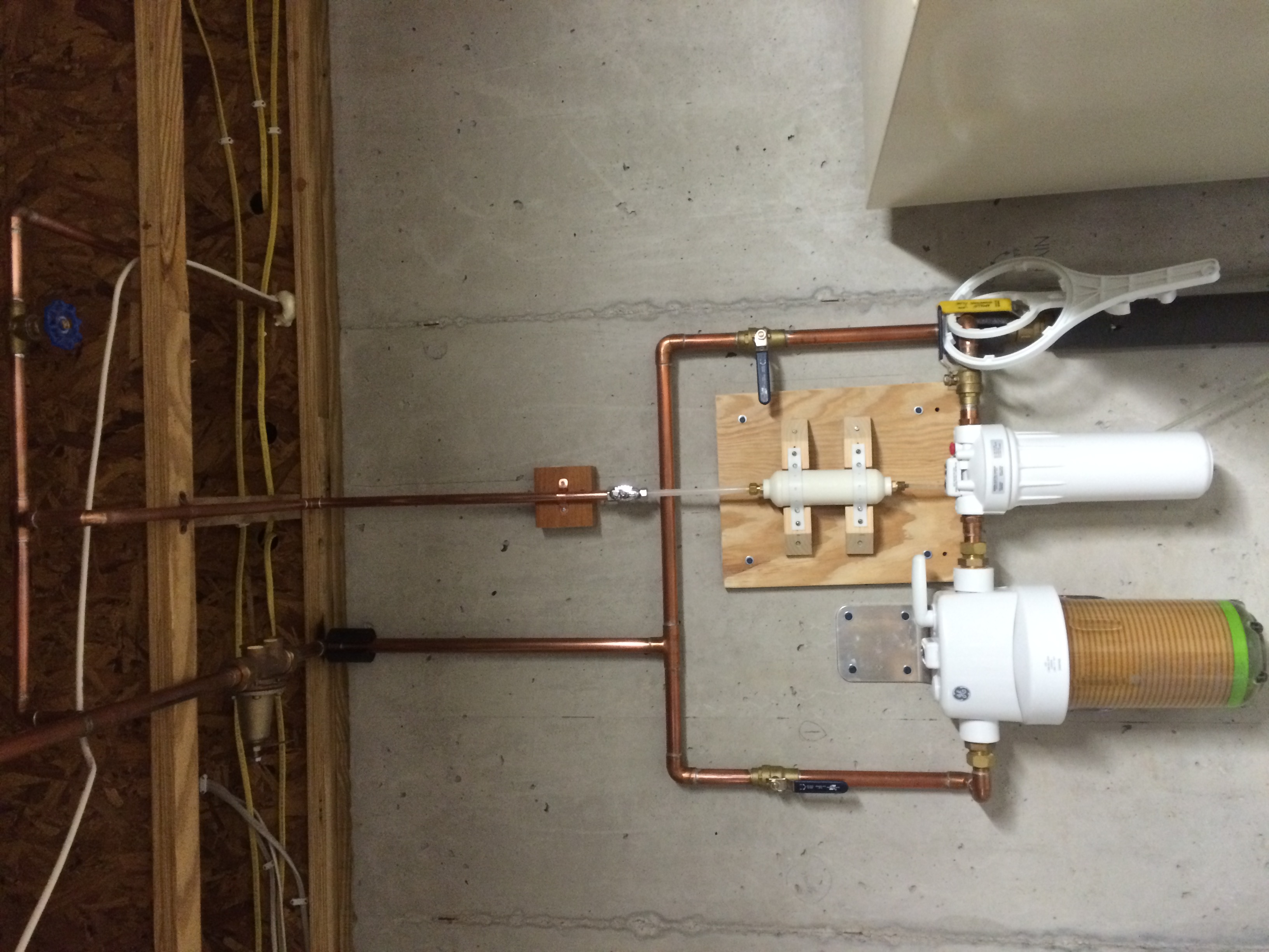

We have sort of a complex situation, a gravity fed spring is our primary, with a drilled well as a backup.
The spring we used for 30 years, but only gives us about 25psi at the house.....you learn to live with it. Last year, I put an inline booster pump, which switches on at 55 and off at 80....and that has been a great improvement.
For filtration, I used a mesh filter pre-screen, then a 4.5x10 x 5micron main filter, then an 8gpm UV light.
The spring and well are plumbed so I can run either with the flip of a few valves. The small pressure tank is for the inline booster pump, the larger one for the well. The well, we have plumbed outside for hydrants and garden irrigation.
The large gray box up high on the wall is a steam generator for the master bath shower located directly above.
