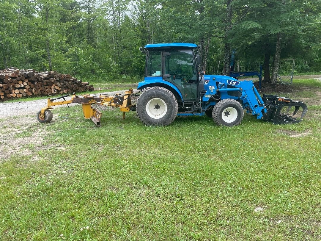

One trick I use to get around having a blade or take with no gauge wheels is to just angle the blade or rake. This lengthens the plane at which the blade/rake cuts so it takes off the highs and fills in the lows. Yes your making windrows in the process and a non angled drag with the blade/rake is needed for a final pass.

You have a very nice setup ! My neighbor drives the grader for the township I live in so I stopped to visit and asked him if he could grade my driveway. I had a foot of new gravel dumped on it the year before and had graded it myself with a rear 3 point blade, it turned out pretty decent but it had a few dips I just couldn’t get completely rid of because of the short wheelbase and the rear mounted blade. The town grader has a much longer wheelbase and the blade is in the middle, took the very skilled operator about 15 minutes to get my driveway perfectly smooth, I would have been happy to pay but he said no charge happy to help you out a little !
