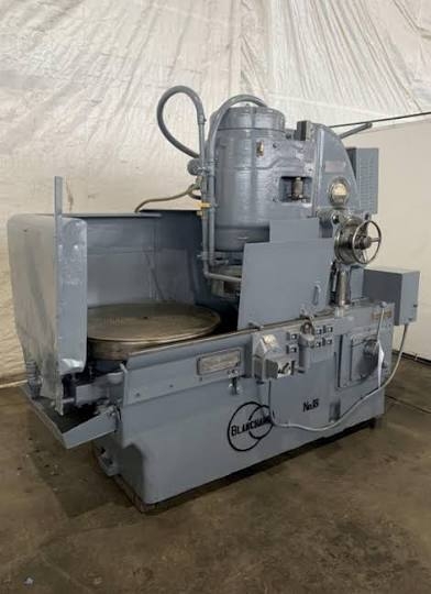

I use to sharpen blades with a Blanchard Mill with rotary stone…
Had several jugs at the shop and could do a dozen or more at a time…
Surface Grinder works too…

A very large hydraulic feed surface grinder with an angle adjustable table mounted to the mag chuck. I use an angle table because different brands of chippers use different included angles on the knives. I also square the anvils (the part bolted to the end of the chipping wheel that you set to have the shearing action. Rule of thumb is about 0.010 or the thickness of a credit card between the closest to the anvil knife and the knife itself and every machine will have a bit of runout so you always check all the knives and average them to 0.010. I charge my customers a buck an inch on each knife times 2 because most of them are double edge plus I can custom grind the included angle if a customer requests it. Most of my local customers are chipping hard wood so the standare 27 degree included angle is about right but if you do mostly softwood, a 30-35 degree angle is the most efficient and requires less horsepower and makes for less plugging. Even commercial chippers can plug up with sappy softwood. Least most of them have access doors in the chute so you can unplug them easily. Had to retrofit a couple Bandits a few years back. No access doors and they are a real labor intensive chipper to unplug. The last thing any arborist wants to do is unplug a chipper while on a job. remember arborists all work on an as bid basis so downtime on a job eats their profits up.

5030,
Could you post a picture of your knife-grinding setup? Since I don't have professional grinding equipment for this, the way I do mine is place them in a home-made wooden jig (all four at once, lined up together) and clamp them to the side of my workbench. Then I use a flap disk to put a new edge on them, keeping them at roughly the same dimension. So far, this is working OK, but obviously it's hard to maintain the 45 degree angle the manufacturer specifies.
Also, no matter how hard I try, I find it hard to get a sharp corner on my anvil. I use a 90 degree table on a floor-standing disk sander, but can't seem to get a real good edge on it.
I would really like to see how a professional does it.
Thanks.
