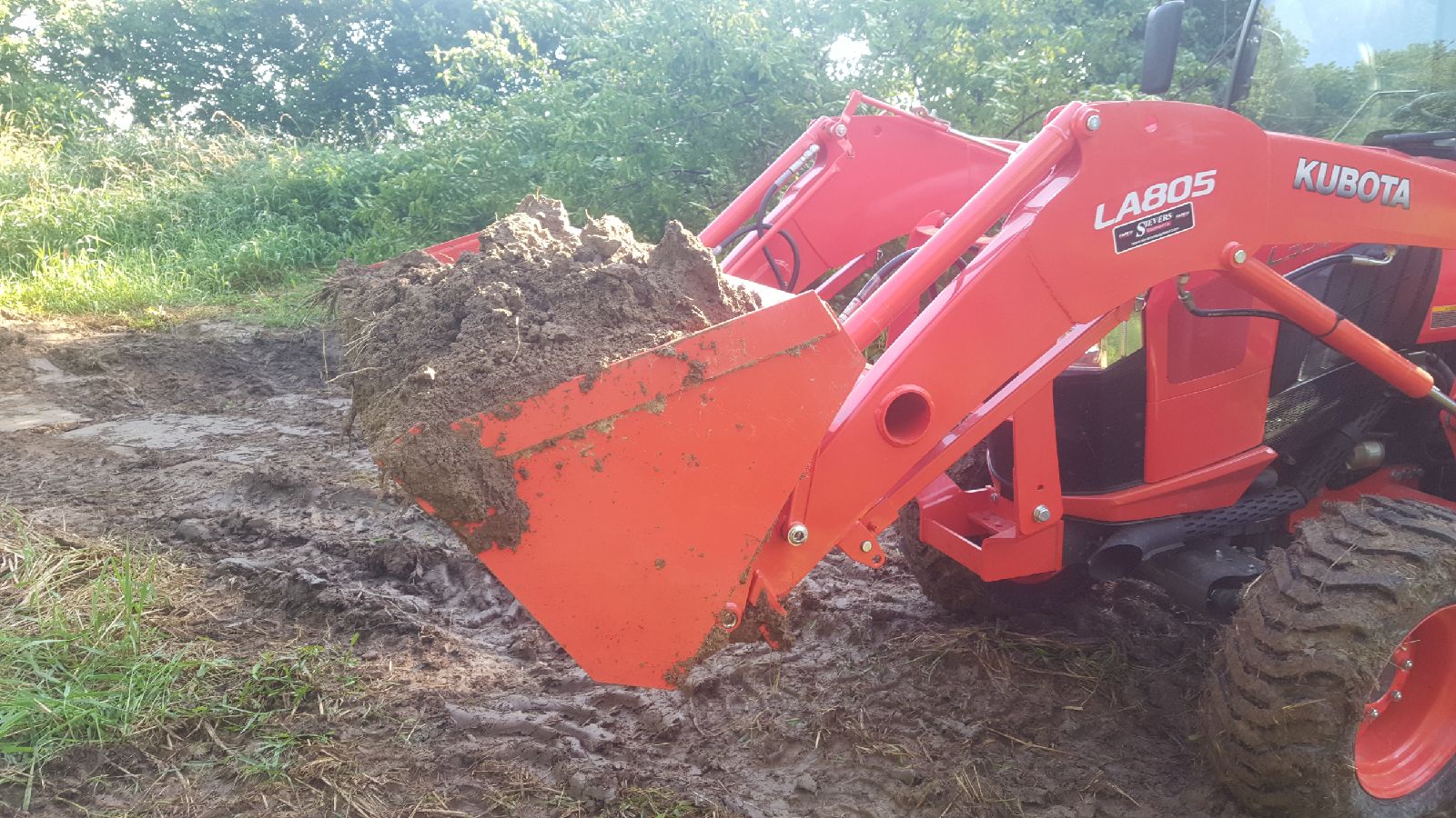

I have the Grand L3560 with LA805 loader and it has done just fine for me. I was moving dirt for about an hour on Saturday.
