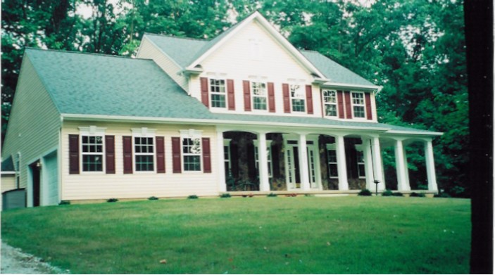

<font color=blue>square two story house of balloon construction is the most efficient use of the building materials and labor. In his opinion, it was also the least attractive(my apoligies to anyone who lives in a square, two story in advance</font color=blue>
Whew...I don't fit that category! /w3tcompact/icons/wink.gif We managed a small bump out on the back of the house to keep it from being the least attractive!
Seriously though, I refer to our place as a "glorified box" and I wouldn't have it any other way. Easy to heat in the winter, simple to construct, and as Egon said, throw on a porch, deck and a few other items and it doesn't look too bad. Take a peek at the <A target="_blank" HREF=http://www.tractorbynet.com/forumfiles/35-149063-NewLawnTwo.jpg>glorified box</A>.
Kevin

Very nice. Little touches make the difference, indeed. The peak over the center, the porch with the little wrap around roof by the garage, the attached garage and the bump out you described all take away the box look. Nice choice of colors, too. Beautiful home. /w3tcompact/icons/smile.gif

<font color=blue> Whew...I don't fit that category! We managed a small bump out on the back of the house to keep it from being the least attractive! </font color=blue>
I'm in the same boat, dress the box up a little bit, and maybe it won't look like a box anymore. I've might have it worse since I got one of those cold dark damp holes underneath my box. Actually, it's heated, dry and well lit. We are in the process of finishing our basement. Whenever we get it finished, we will have added 900 sq ft of living space and an extra bathroom. I'll still have my work area in the unfinished portion of the basement: exposed beams, concrete, insulation, wires - just the way a workshop should look.

BTW - nice job on that glorified box.

Your house is very nice! We almost went with that deep country red/cranberry color that you have. It is a classic color and looks really sharp!

Nice looking home /w3tcompact/icons/smile.gif
