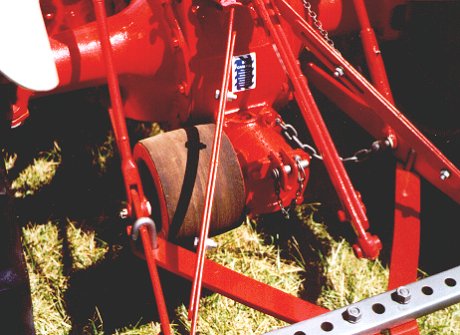

I seem to remember that older Fords could be equipped with a 3pt "flywheel" attachment that allowed the PTO to power belt-driven equipment, including saws. Is my memory failing me?
Steve
