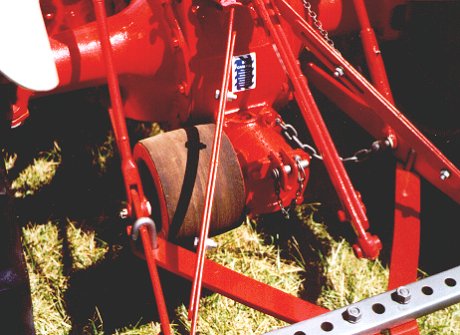

I seem to remember that older Fords could be equipped with a 3pt "flywheel" attachment that allowed the PTO to power belt-driven equipment, including saws. Is my memory failing me?
Steve
Your memory is fine.
From:
Ford tractor original accessories

Very interesting. Thanks for posting. I've also wondered how to make a saw work off a tractor and those look really nice.
Any of the old saws that were designed to run on a stationary motor or other power source can easily be converted to PTO by putting on a shaft with splines and pulley. My neighbor has an old home built saw that he powered with a Fordson Dexta

That's a relief.;)
Just curious. How was the pulley geared? For example, if the PTO was turning at 540 RPMs, how fast was the pulley turning?
Steve
If I remember correctly, there are about 1250 rpm on the pulley at 540 rpm on the PTO
