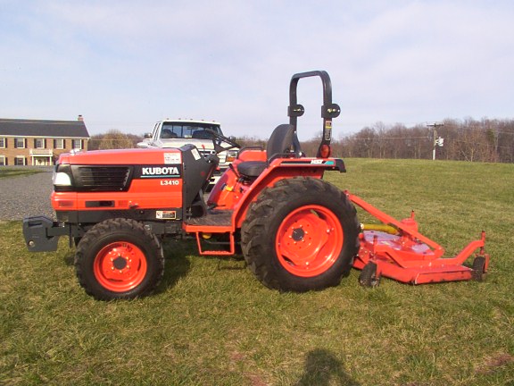

That being said, I think I'm one of the few people on this board who actually bought too much tractor. I originally had over 10 arcres to maintain (mow, etc). However, over the last couple years, my maintainable acreage has been recduced to about 1.5 acres. I have a Kubota L3410 without a loader.
I originally thought that I (and my wife) would use the tractor for multiple farm chores. However, she has never been comfortable on the tractor and chooses to do her chores by hand.
So that leaves me with a GREAT tractor that I mow 1.5 acres with every other week. I'll be lucky to put 30 hours on the tractor this year.
I tried to sell it. However, with the rebates in place and the fact that I don't have a loader, no one was interested. It is a pretty expensive mowing machine.
If you know anyone who is interested, let them know quick, because I told my dealer to order me a loader. Should be here in a week or two. I figured if I couldn't get near 15K out of it, I was just going to keep it.
Maybe I can get the wife to not be afraid of the tractor.
Anyway, I bought Orange because I was more impressed with the overall tractor than the NH (and more impressed with the dealer). However, I did like the ergonomics on the TC33D.
