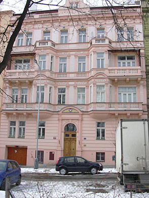

From what I have read, Bob, people who went with ICF for the basement typically wish they build their whole house with it.
There is something about sleeping in brick and mortar house, at least for me, European house feels better than American stick built house. Maybe because I grew up in apartment house with ceilings 12' and outside walls 3' thick?
First balcony on the left, but my bedroom was on the other side - total about 100 square meters for 4 people.
