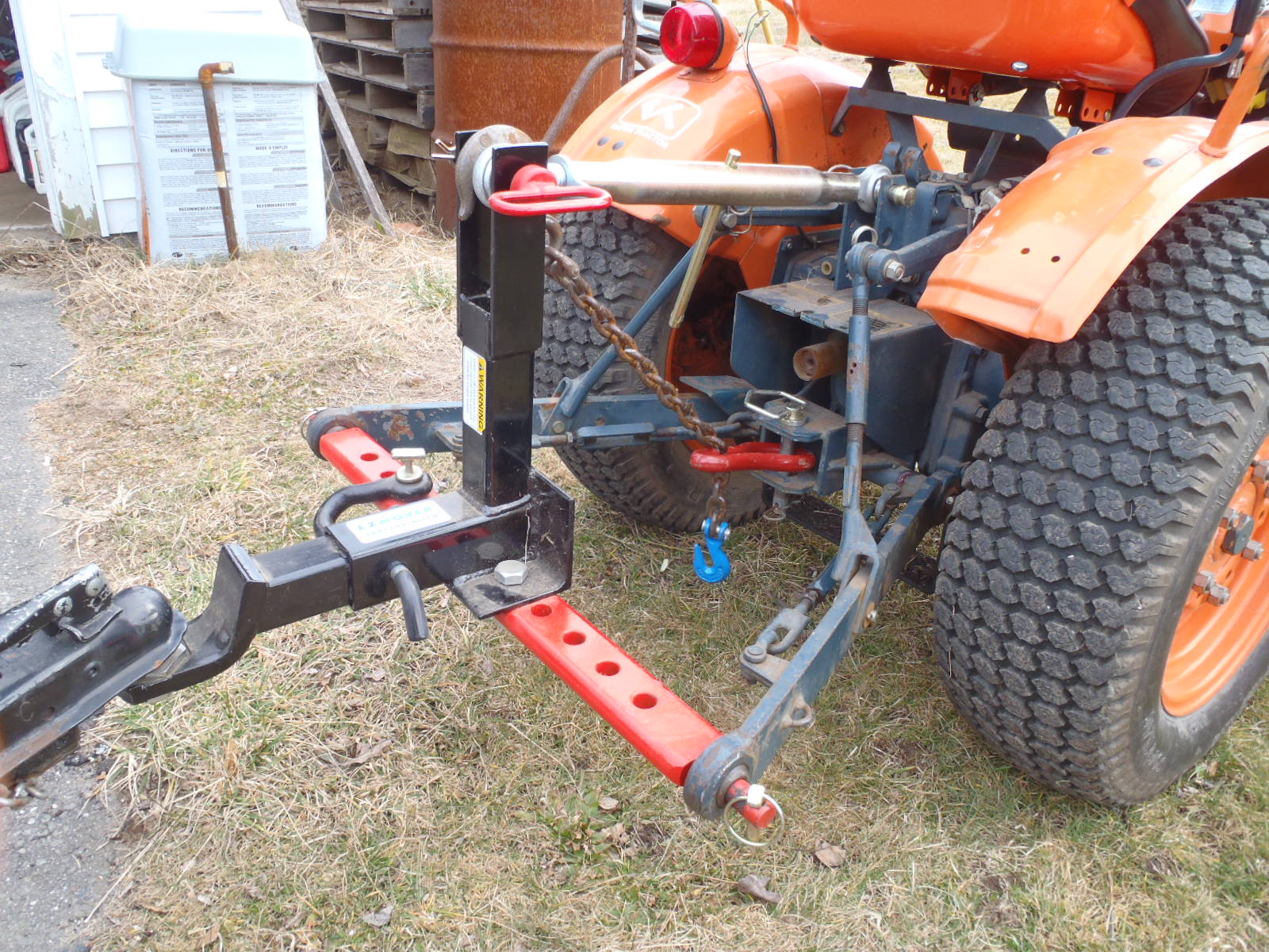

I plan on using my 4x8 utility trailer behind my new to me BX24. Why would I need a 3 point hitch mount or one of the Bxpanded receiver hitch mounts when there is already a hole for a ball to be installed in the plate on the rear of the tractor. I'm sure I'm missing something as I have yet to even remove the BH yet to get a good look at the rear of the tractor but that hole seems like all I would need to install a ball and use my trailer.

I just use the hook on my quick hitch to grab the coupler. If i flip the handle than the latch closes on the coupler and will not allow it to come off. Simple, easy, works and its free!
   / Why buy a ball hitch mount? #7
Remember that a three point with a trailer ball hitch can ride up if the load is at the back of the trailer. With the ball on the frame the tonue of the trailer will not move up or down for that matter.
A three point hitch mount is good for getting under a heavy tongue and not having to connect by hand......all in in what you need.

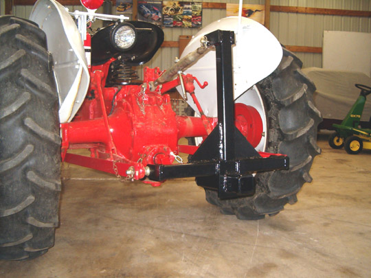

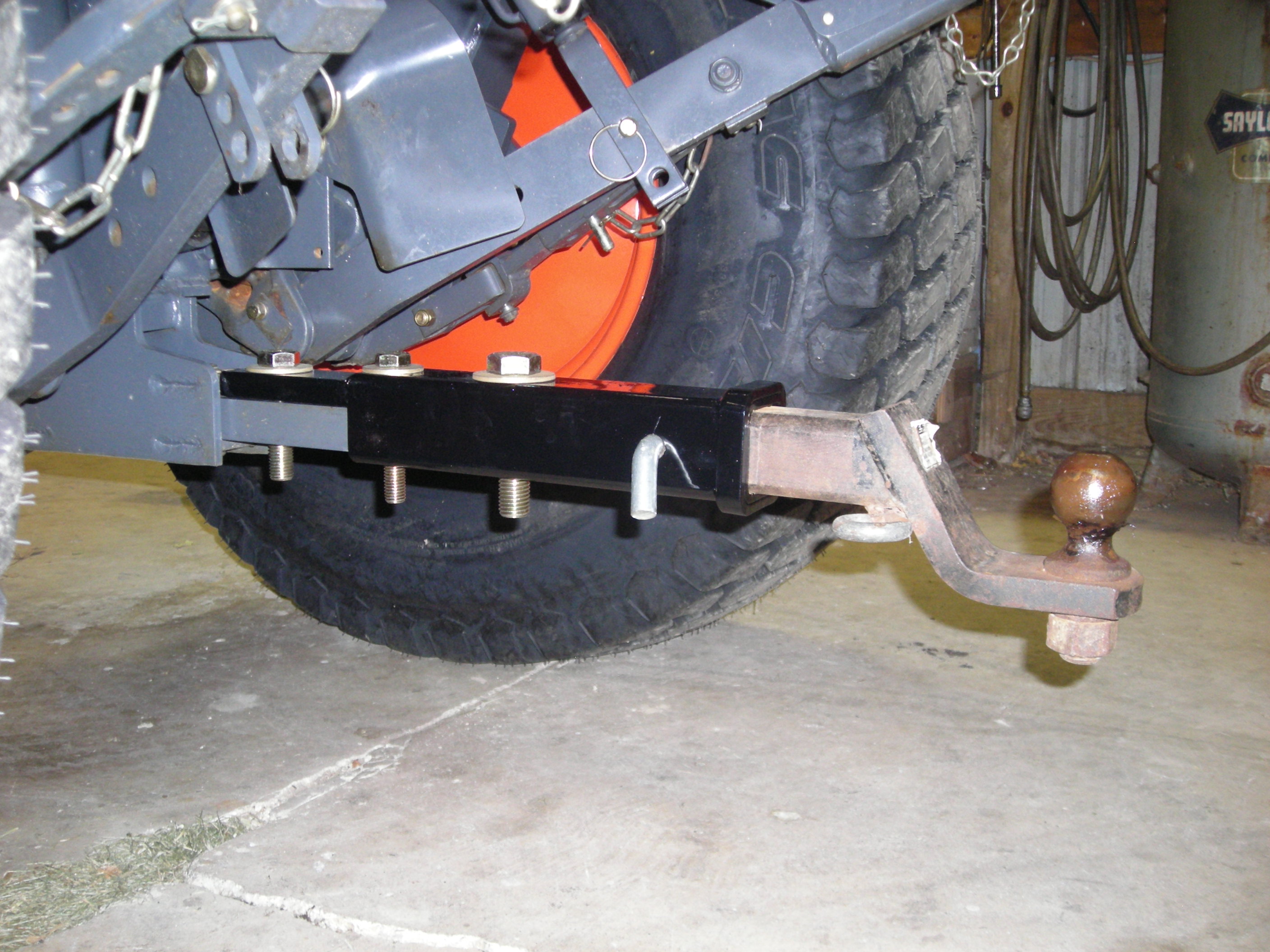

   / Why buy a ball hitch mount? #8
Here is what I use, depends on what I am doing and what it required. Others above have made comments about pros and cons above. Made myself. Philip.

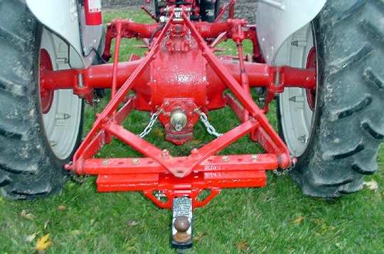

   / Why buy a ball hitch mount? #9
Using the 3pt hitch allows you to level the trailer, and to lift the tongue so it doesn't dig in when crossing a dip.
Tom Seller and sandyc brought up a good point about the 3pt - it has no down force, so it won't resist the tendency of the tongue to lift, which can be a hassle or downright dangerous, depending on what's happening at the moment. I chain the toplink to the frame mount, which prevents this from happening:
