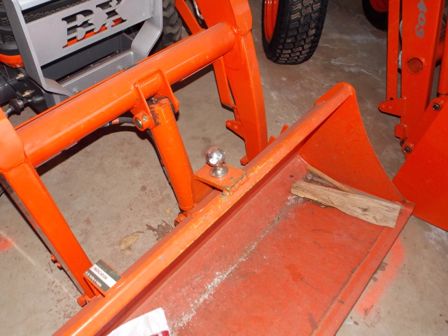

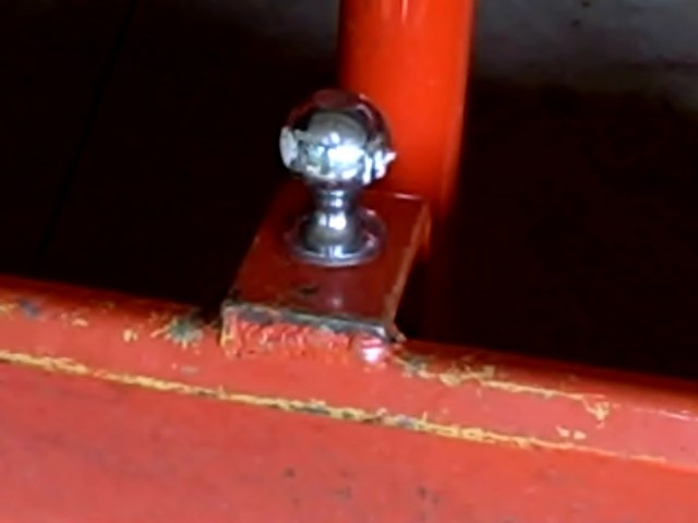

I had a ball hitch installed on the bucket of my BX25. It's not good for big turns, however, it's nice to have in a pinch.

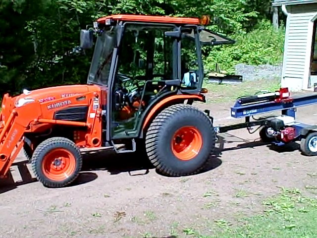

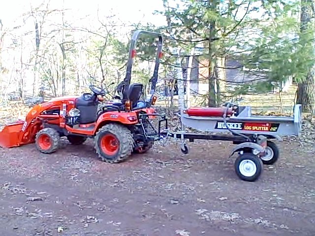

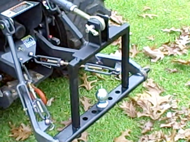

   / Why buy a ball hitch mount? #15
Here's my version of a 3-pt hitch tow ball. I went to a local Tractor Supply and purchased the drawbar. Then mounted a 2" ball. The H bracket was fabricated by a welder I know. The whole thing cost about $80. It's good for light duty towing and can be swapped between my BX25 and B3030.

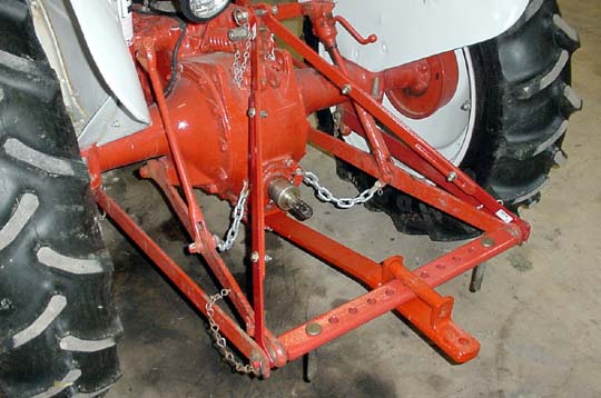

That is one thing everyone does, but only once! Once bars are in place, make sure you disconnect the pump drive on the N series, or close the 3 point control valve on newer tractors. Here is a half way decent pic of the stay bars. Philip.
