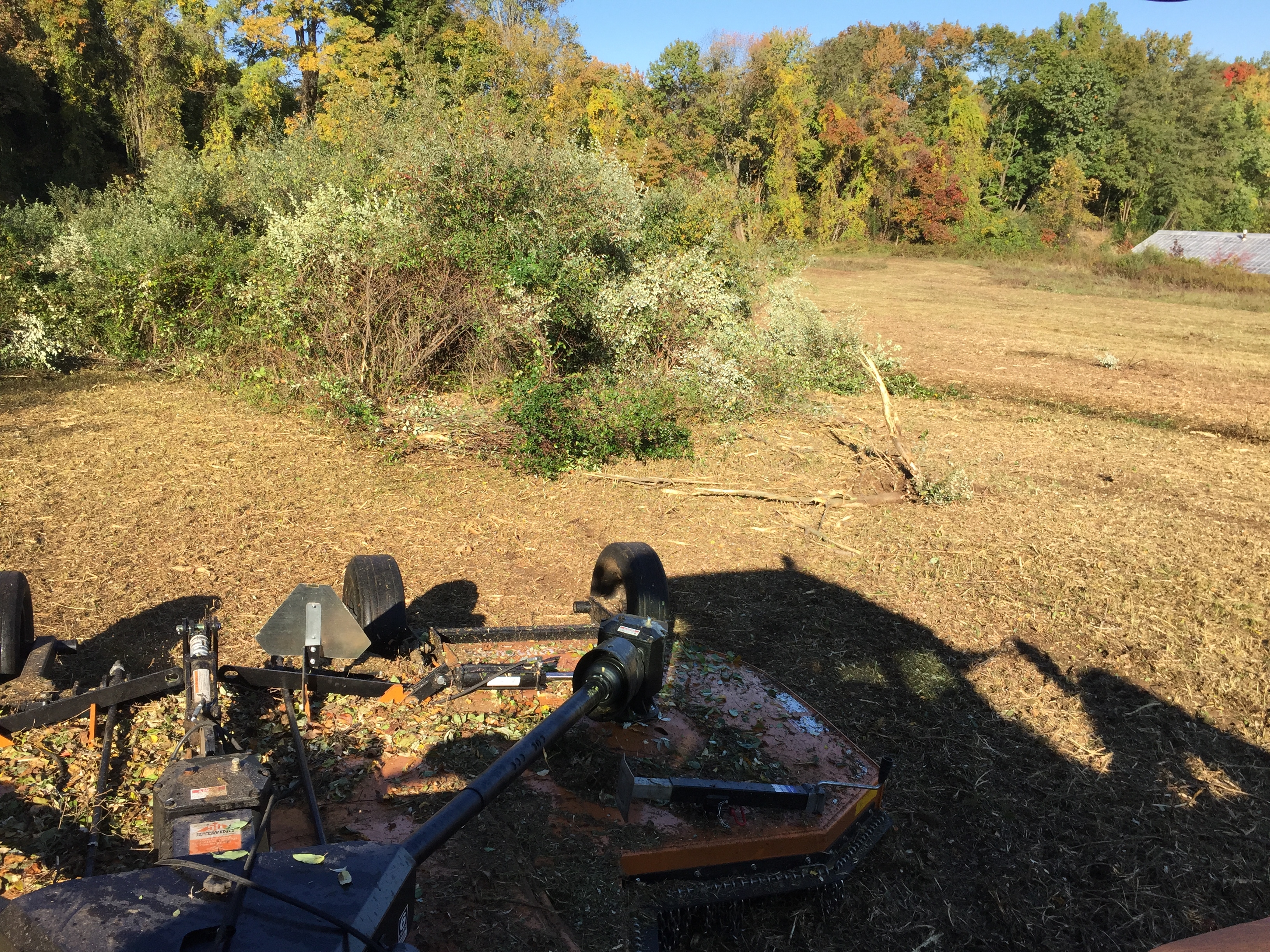

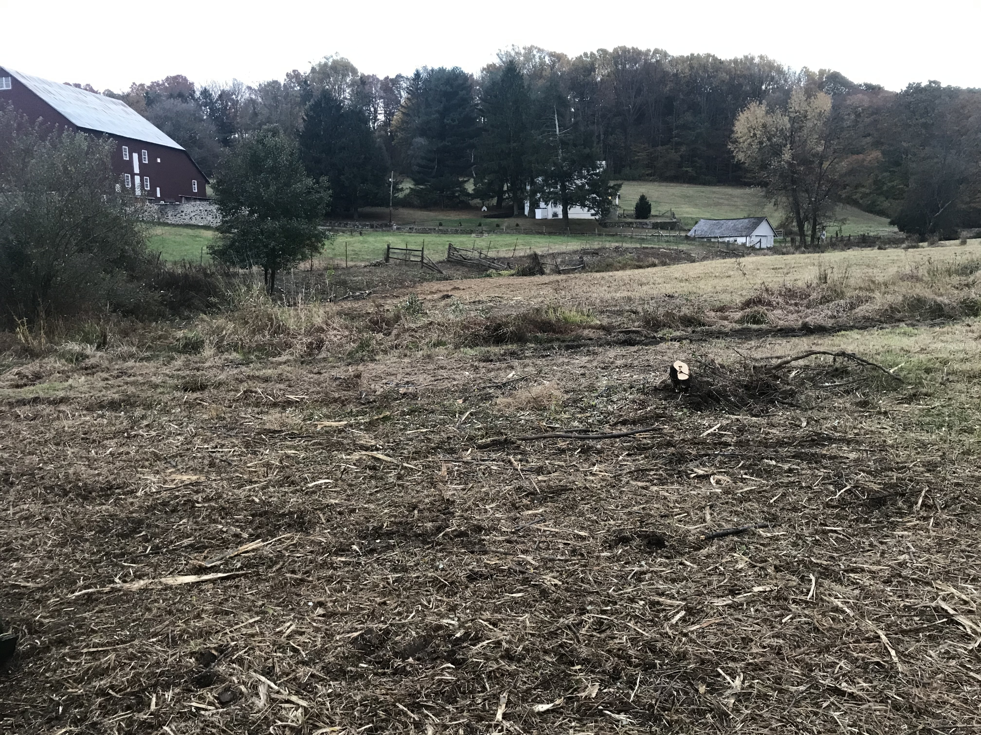

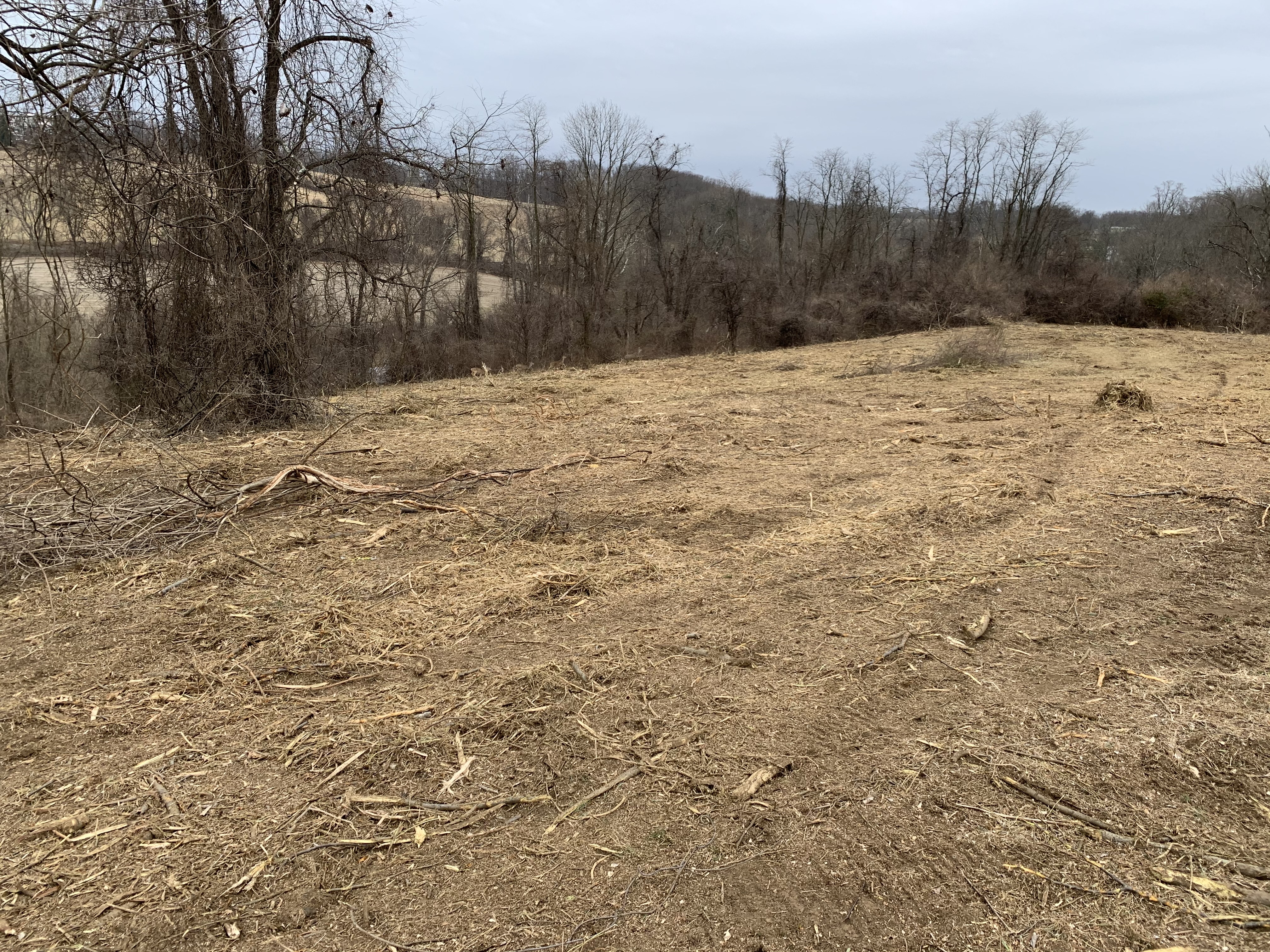

Here’s some heavy crap I got into with my Woods Batwing a while ago.
15’ tall. Definitely 3” plus. Once I got beyond this size, I would typically rent a tracked skiddy with a mulcher.
Why beat up a bat wing on heavy crap.
This was even nastier.
Did this with the CX-15
Swampy & heavy.
