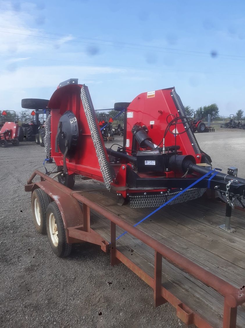

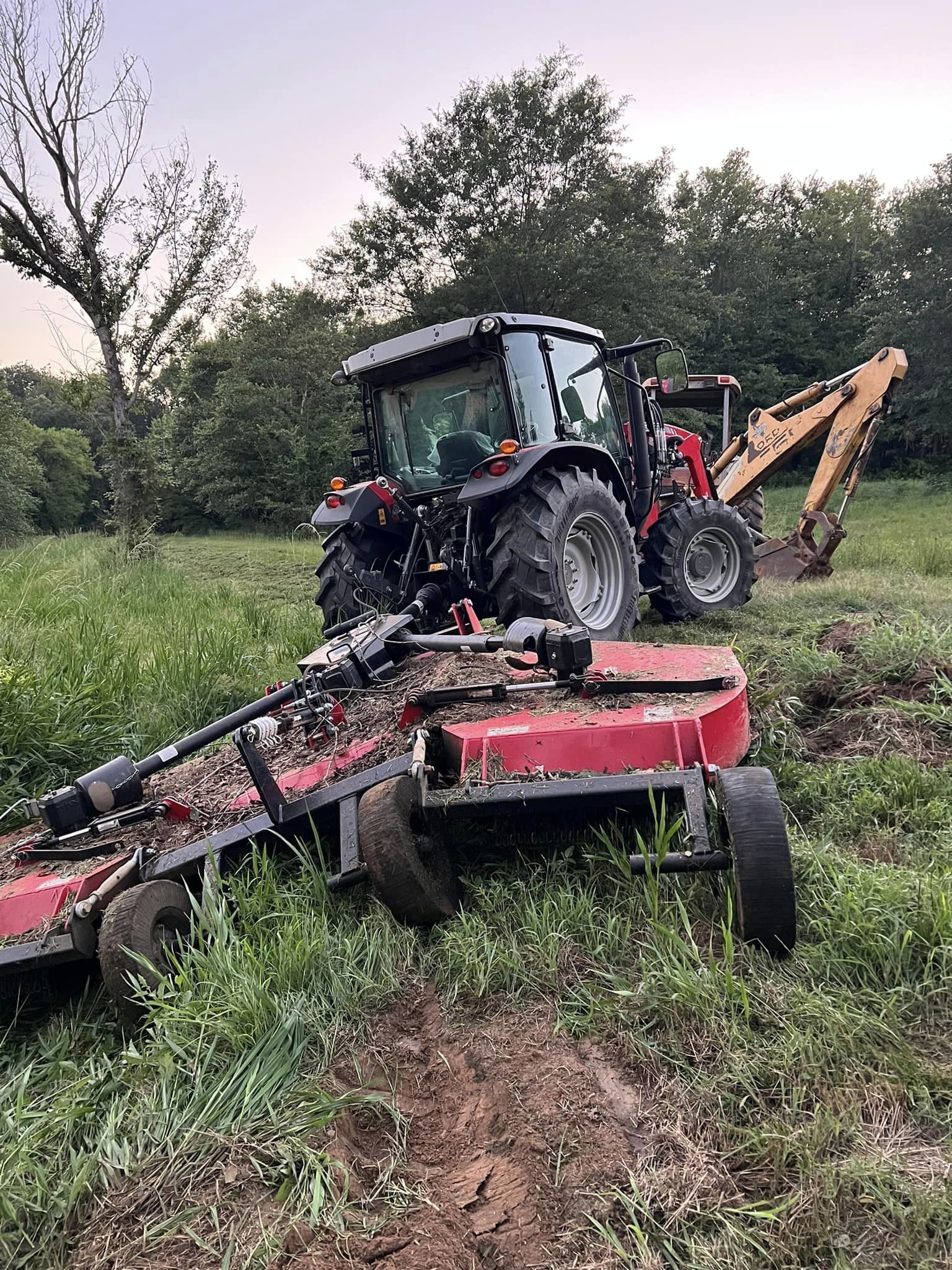

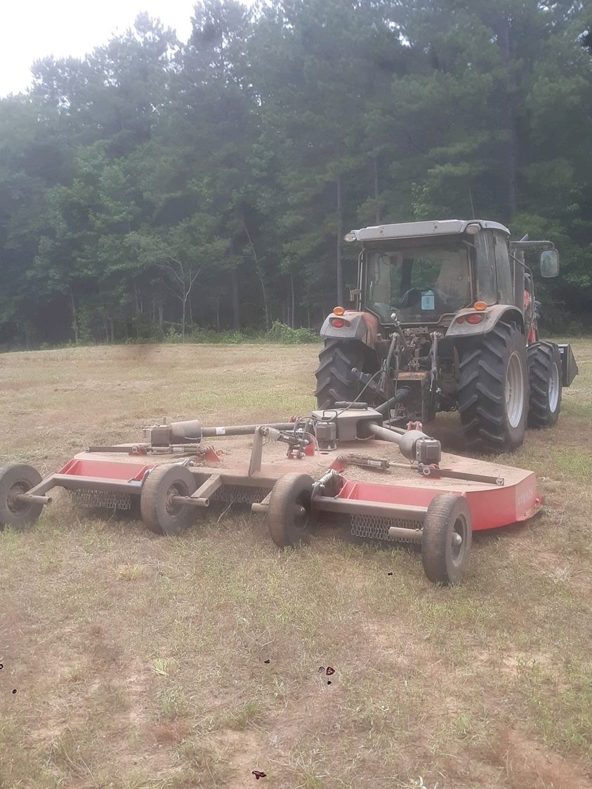

My only experience with 12 foot batwings is the Titan 1912 that I bought a year and a half ago from my dealer after getting my Massey Ferguson. At 70 HP, I felt that 12 foot was a good size for the tractor. After buying it, Titan was forced to change their name because there was another company with the same name in the same state that sold similar products. Now they are called Ironcraft.
I looked at some used batwings that where stupid expensive for the amount of wear on them. At that time, it was very hard to find a new 12 foot batwing of any brand in stock anywhere near me. The Landpride 12 foot was very pricey, very light duty, and the used ones I saw where just about falling apart. I like Landpride, but those mowers looked really bad. I looked a couple used Modern 12 foot cutters that where rusting out. I got the impressing that the galvanized finish wasn't very thick and that it wears off fairly quickly. Rhino really impressed me, but they where almost $20,000 for new and I never saw a used one. The few Woods that I saw where used, but in decent shape, but they wanted $15,000 for used!!!!
I paid $13,000 for mine brand new. $3,000 down and $181 a month that I'm paying off with bigger payments every month.
It only has one hose from the remotes. That hose lifts the wheels and then lifts the wings. When I get to where I want to be, I just release the pressure and it slowly lowers down the the mowing position. There are some aluminum blocks that go into the lever for the wheels that you install to get the mowing height where you want it. In my opinion, mowing quality is fantastic. It cuts everything I've been able to drive over. Some stuff is over my hood, other stuff is close, and maybe over it's 2 inch rating. On pasture grass, it's fast with super nice results.
I'm still on my original blades, which have started getting some chips breaking out of them. I might need new blades next year, or the next. Now that I have my place pretty much under control for the first time since buying it, the wear and tear on the blades will be less.
My only issue with it has been that one of the gear boxes on the Right side wing came loose. The bolts where not tight enough from the factory and it started shaking around on my, which ruined the threads on the bolts. I replaced them with Grade 8 bolts, crown plastic locking nuts and loctite. It was a pain to do by myself since you can only use wrenches to hold the bolts, and it's impossible to hold onto them from both sides because of the deck being in the way. I had to wedge one wrench into position and turn the other. Since space is so limited, I could only turn an eighth of the way at a time. Most of the time the other wrench would fall off. It took me two days to get the four bolts on and tight, but that was probably a total of 6 hours work. I just got frustrated after a few hours the first day and quit when I had two of them done. Since then, no issues at all.
For the money, I think it was a good deal. So far, I think it's a good mower. If I had more money, I might of bought the Rhino.
291494060_10228300584122436_1508093882039791749_n.jpg290646293_10228300595722726_6421015968374262114_n.jpg356366219_10230740108989033_4510855409365016067_n.jpg

Yes. My guess is both... On one side now, it's getting new bolts and double nutted.
They got to where they wouldn't tighten, and I use a long cheater. It still vibrated so badly it wore the splines on the stump jumper to the point of needing a new one... Those are only about $600 each. :oops:
The gear oil coming out the vent nut was explained to me by the factory folks as it is a symptom of the direction the gears are turning inside the box. The Viper wing boxes spin opposite directions, although the utilize they same gear box housing, so the location of the vent nut has to do with oil splashing through the vent as it's running. But really both sides sling oil.
For the last bit of my season, I talked with the factory guy and asked if I thickened the oil by running some grease from my grease gun in the box would help. I got his blessings, and it did help. So I'm going to go with corn head grease in the gear boxes, rather than the standard 80wt gear oil. Lots of folks are going to corn head grease ( 0/0) to keep in their shredder gear boxes now.
Mine weren't overfilled. But sometimes I put a tad more in if I had a long hot day ahead of me. My main concern was keeping the gear boxes running with lubrication, despite the mess it made on the wings.

Eddie, mine came the same way, but I separated the hoses and fitted the wings with their own hose and remote fitting so that I could run them independantly.
Sometimes I have need to raise the deck as the cutter is running, and don't need the wings to raise. Like crossing an obstacle or road.
I know they say you can run the batwing cutters in the upright position, but I'd sure hate to do it much, as it would be much harder on the U joints involved. I like to keep all those drivelines as straight and level as possible.
If I have to raise the wings when cutting when going through a gate or something, I shut the shredder off, raise the wings then restart it after I let the wings back down.
