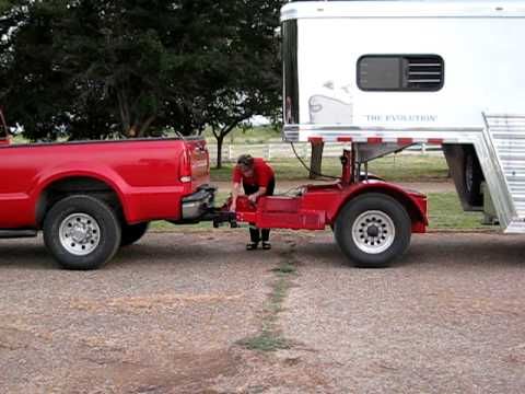

I would think if you were pulling something heavy there wouldn't be enough weight on the rear axle and it could get away from you. It is one thing when you have a tractor with a lot of weight on the rear tires but on a pickup pulling say 14K or more it could jack knife pretty easy on a downhill grade. On a semi pulling double or triple it has part of load over the drive axles and it is connected over the axles not far back.
That is my guess anyway.
I have seen my father backup our hay wagon which had a connection like that but he also had 60 years of practice to get it down.

Why would that style trailer be any legally different than this?
Bruce
Because the Automated Safety Hitch System is USDOT certified, and is in the certification process in the Canadian provinces. Quebec province considers the Automated Safety Hitch System as part of the trailer, and all remaining provinces consider the Automated Safety Hitch System as part of the truck.
The Automated Safety Hitch System literally extends the frame of the vehicle. There is only one pivot point....where the GN trailer attaches

vsteel has it right. The weight of the trailer will take over if the tow vehicle is unballasted. A standard trailer putting weight on the tongue solves the safety and traction problem for a lower total weight.
Truck and trailer (class 5/cdl) is the standard construction/ earthworks configuration in new zealand and we load the truck with ballast for safety/ traction when doing machinery shifts.
