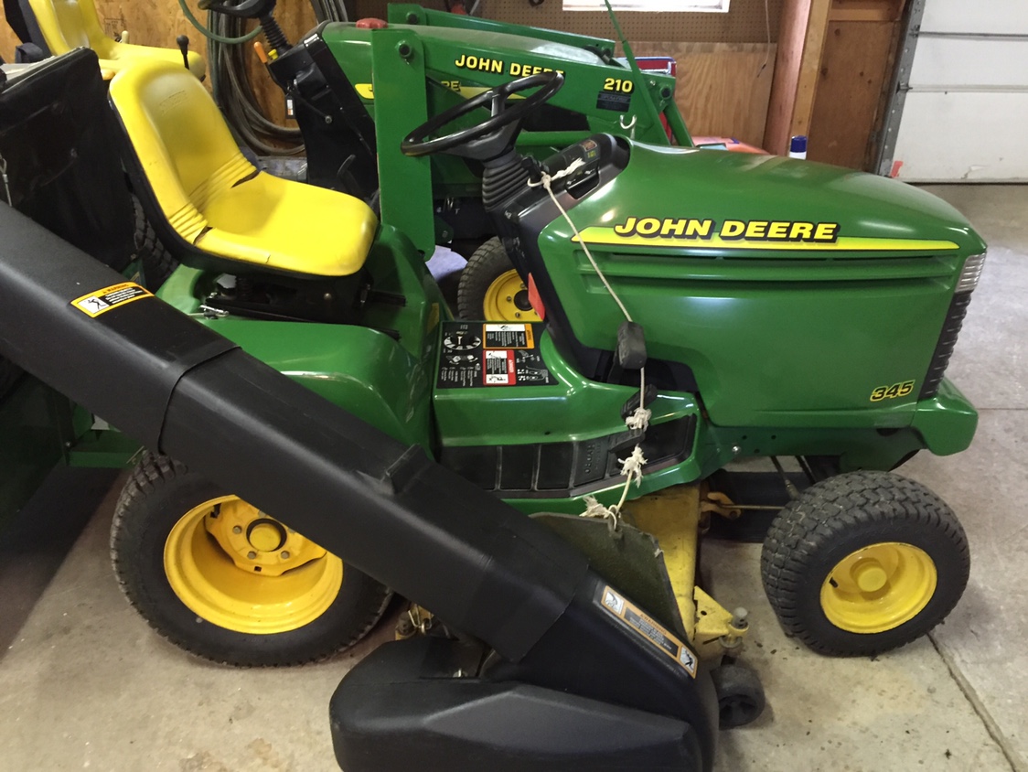

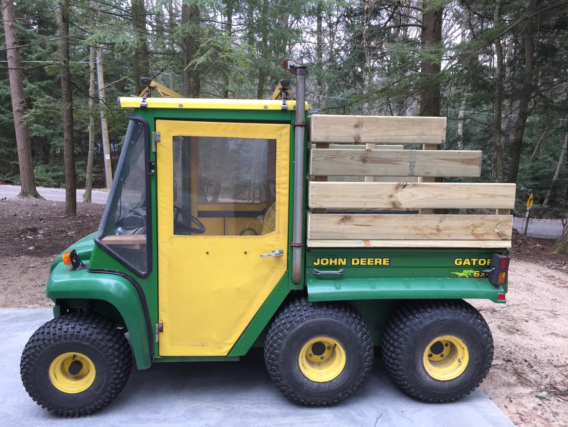

The JD dealer replaced the plastic CAM with metal on my 2000 6x4 JD Gator when they replaced the water pump because it was torn apart already and it had just over 1000 hours on it.
Gator is a little louder now, has the wine of a muscle car with an oversized cam. That, I don’t mind at all. Cleaning up with Gator 6x4 - YouTube
Never did replace it on my 1996 JD 345 with over 2000 hours. I sold it a couple years ago and it was running great.
The gator does not use oil after the new cam.
