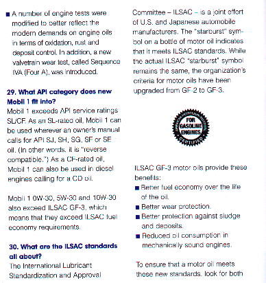

Mobil specifically states that Mobil 1 which is SL/CF is suitable for all light diesel engines that required CD spec oil. That means according to my Kubota manual that recommends a CD oil then that Mobil 1 is a suitable oil for my Kubota. A call to Mobil confired this. It is also clearly stated in their brochure on Mobil 1 oils. A small compact tractor is a light diesel, a 500 horsepower or more CAT turbo-diesel installed in triplicate in an offshore oil field service crew boat would not be, for example. J

Odd, my manual--2410 --says CC or CD. Mobil 1 is a CF oil. Very strange. J
   / Why "Diesel" oil? #19
Re: Why
That is also odd, it dropped my pic. J
   / Why "Diesel" oil? #20
Re: Why
You have a newer tractor than I do. I was looking in the Kubota Workshop Manual Tractor B5200-B7200HST. It called for service class CC. On the other hand, http://www.kubota.com/maintenance3.cfm specifies CC,CD and state that CF, CG-4 are accepted for use in Kubota products. So, guess that means mobil 1 is ok for use in a kubota.
