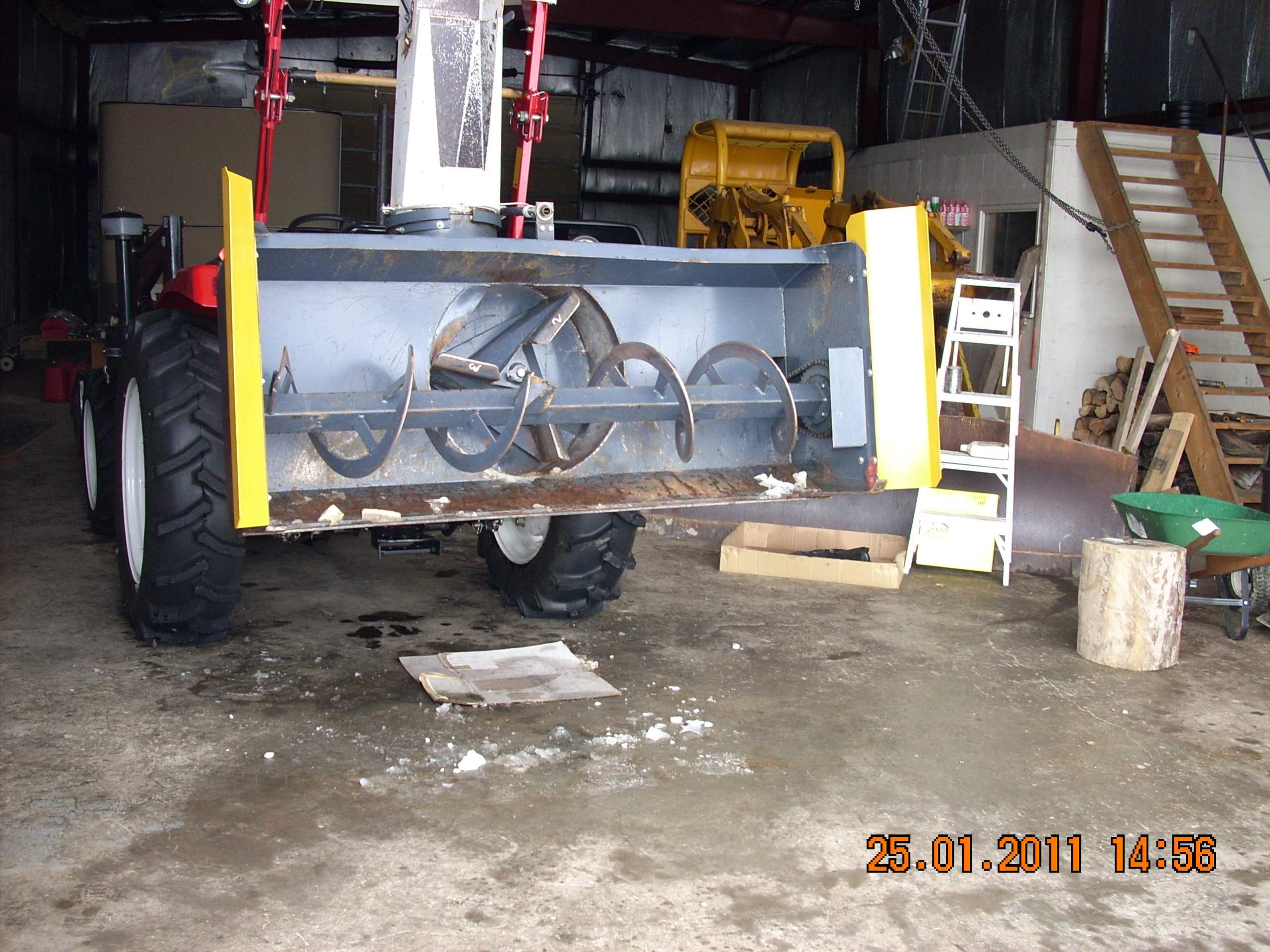

You really do want the blower to be a bit wider than your tires. It will especially be noticeable when making turns(sharp or gradual). I have heard of people adding wings to the blower which may eliminate this issue.
   / why do snowblowers have a maximum recommended HP? #7
Here is what I did. Not expensive - $50 for the wings cut and bent to shape.
