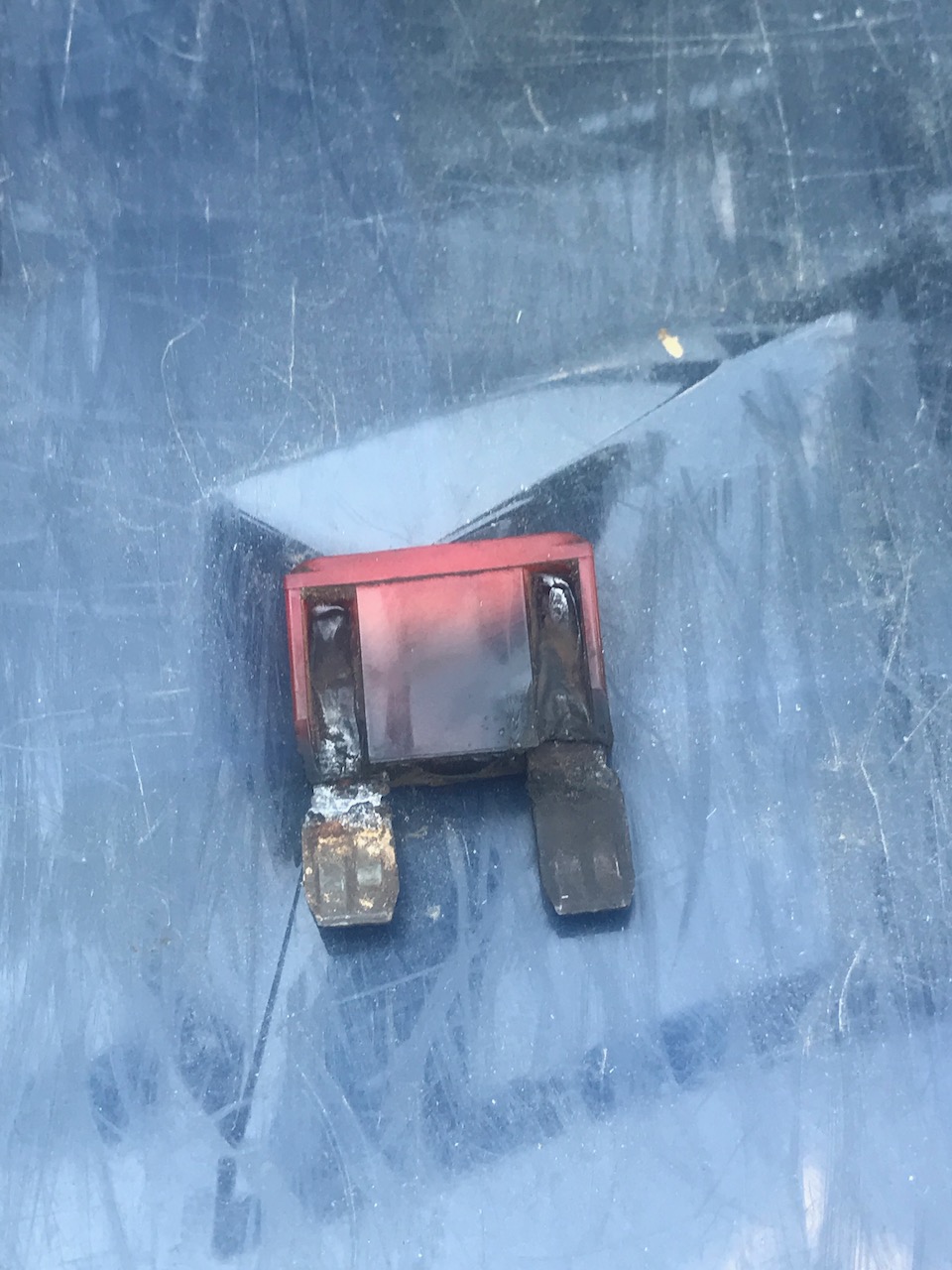

So, mowing, nose down at about 35 degrees and a foot from the 90 degree, 10ft drop off. And the whole tractor just dies. Nothing, no juice, nothing... Painful walk up to the shop, grab all the tools I can think I might need and back down I go.. After digging for a while I find this little plastic box next to my rear electrical connectors. Pull it out, take a look and realize that instead of having a fuseable link I have a giant fuse that is, well, take a look.
I am not sure how or when this happened. It seems old, and the tractor has a few electrical issues when I got it. So who knows. Walked out, drove into town, and got another fuse and back to mowing but man, why can't this thing just pull out of the shop and fail there.

That fuse is a symptom of your bigger problem not your problem replacing the fuse and not fixing the problem is behaviour that leads to a bigger problem in a more awkward place and time in the future exactly the issue you are complaining about

So,...do you have any idea what caused the draw that caused your 100amp fuse to blow?
You seem to have more than a few of these "not a great place for a breakdown" breakdowns.

I've had some wear/fatigue in those wires and figured out that the 1850 operating envelope is a good way to get a gravity assisted short.

For starters his fuse holder is junk. An overload would have blown the fuse and MAYBE caused a little heat discoloring near the top of the fuse. The burnt spades indicate a poor connection between the fuse and the contacts of the fuse holder.

Roger that, the poor connection at the fuse spades generated heat which started to melt the rest. Anyway you are lucky the tractor didn't coast over the edge. I know when I am working like that, down hill with a drop off, it is a little nerve racking with no brake pedal.:shocked:

Rick. Thanks for the advice. I did a deep dive on it and it’s in a very dirty place on the tractor with little protection. Ordering a different holder. Ms on my machine we have automatic locking brakes. The second the engine dies all wheels lock. This machine is designed for 45 degree slopes.
