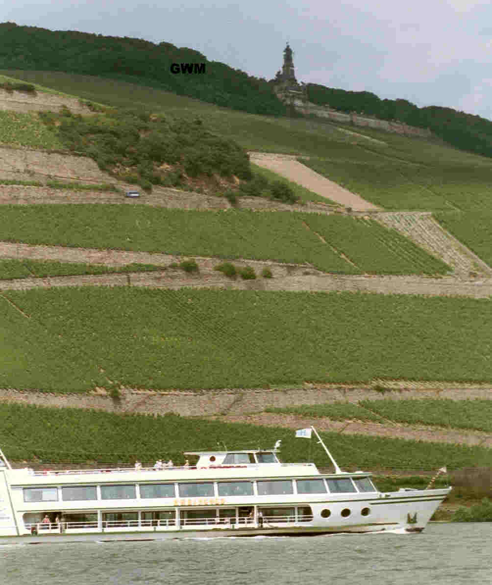

   / Why do vinyard tractors have 4 large tires? #15
Some of the vineyard tractors have to deal with some pretty good slopes. The design you mention Rox may be for this reason.
Vineyard on riverside picture.
