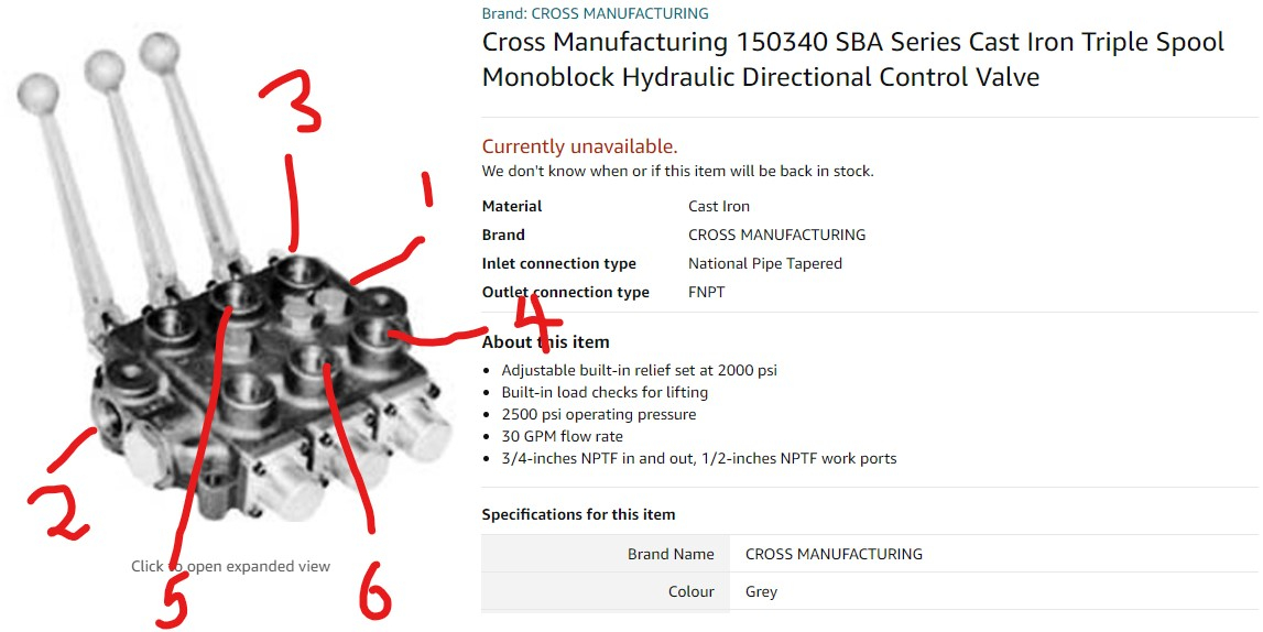

I have a Ford 770 FEL on my 1700. When I put the FEL into float position, the bucket goes up. Obviously, this isn`t right. The original Cross two-function control did this but I put a new three-function Cross control on it and it still does the same. What`s that all about?

It is a brand new Cross exactly like the original except that it has an added control which I am going to use for a hydraulic top link. It does have PB that is plugged. The boom does move up when the lever is pulled rearward. The valve only has detent on the down stroke of the boom. Power beyond does not feed the 3 point. The FEL is fed from an adapter that is bolted between the block that originally fed the 3 point and the lift housing. Rodrocket may have a good point. The original hoses are only 3/8" whereas the pressure and feed ports on the control are 3/4". It was that way when I got it and didn`t have any problems with the FEL other than the float problem. I think the adapter is threaded for 3/8" so a larger hose may not be feasible (unless I make a new adapter with a bigger return port). Thanks for all the input.

Do you have a diagram of the new valve? Float should be A and B ports tied to tank as LD1 described. I think 3/8 hose is plenty big enough for the tank line.

This is the control I bought. 1 is the hose from the pump, 2 is the return, 3 and 4 control the boom, 5 and 6 control the bucket and the other two will control the hydraulic top link when I get a cylinder..
