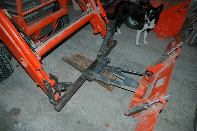

I don't want the float to dump the bucket. I want it because I've been working on adding a snow blade to my loader. In fact, it's done and works except for the painting and hydraulics to angle the blade. I plowed snow with it yesterday. I'll attach a picture. Figuring out the hydraulics has been a pain because of the different type of connectors I needed. But I think I've figured it out. Several years ago I purchased a used blade thinking it had the hardware to attach to my B2400. Wrong! The hardware was for some other Kubota. The dealer wanted over $1000 for the mounting hardware so it sat in my barn until about a week ago when I saw a simple way to attach it. However there were some physics I had not thought about. For instance, when the blade is angled and the blade is pitched up or down, one side of the blade is lower than the other. Which means either snow is missed or the blade digs into the ground on one side. This means that the mount needs to be parallel to the ground. If I use float position on the loader arms the loader arms will dig into the ground because of my attachment design. Not good. So I thought that by using float to control the pitch, the snow blade would follow the contours of the road. It seemed to work based on the limited testing I did before I realized I had no down control of the arms.
Disregard what I wrote about the loader arms digging into the ground on float. Because I've just figured out and tested that they do not. When I tried it before the blade must have been pitched up. I'm going to go test it in the snow after it warms up a little. Thanks MarkV. If I hadn't written this response, I never would have thought about it.
