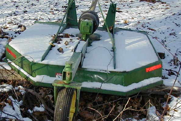

I have the JD 513 Rotary CUtter, and reinforced the rear of the deck with some square tubing. This fix keeps the thin steel from bending, which happens mostly when backing up and plowing into dirt, etc. Doing it before it bends is a lot less work than having to bend the steel back straight.
I took the picture with some snow on the deck, hoping the square tubing would show better.

Thanks for the pic. I'll take a look at mine today. I'm keeping my equipment at my neighbor's until my house & shop is built. He does heavy equipment & welding work, etc so modifying it should be easy.
