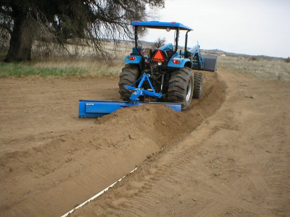

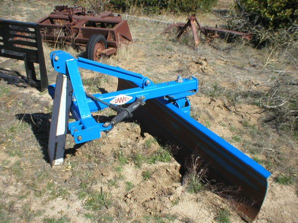

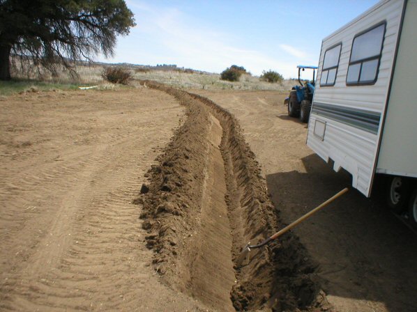

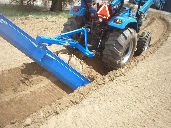

Any chance of pictures of your blade hitched up to your tractor? 5-600lbs should work ok. My first rear blade weighed 680lb I think, it would roll the dirt as in the picture. No a lighter blade is not going to work as well with harder ground, but you say that your ground is shovel soft, most any blade should be working. Your boom should be just about parallel to the ground. The blade should be built so that the cutting edge is pretty close to the correct angle to be cutting most material.
Some pics of my first rear blade

Hey, Something is wrong with those pictures, WHERE are the rocks? That setup is doing a beautiful job. Ken Sweet
   / Why doesn't my rear blade cut? #24
Rocks, what are rocks? We don't have any stinking rocks around here. :D I did that ditch for a temporary water line, about 18-20" deep. If I remember right, that was about a 90 minute job, dug, plumbed and back filled, for 240'. :thumbsup:

Very nice pics, :) they show so much. Never mind the rocks, no boulders or stumps??? :D:D

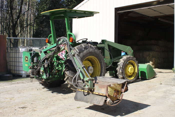

I have the boom flail mower I've been working on hooked up right now, but I plan to unload it in the next day or so - so that I can hook up and get pictures of the blade. Should have pix by the weekend.
