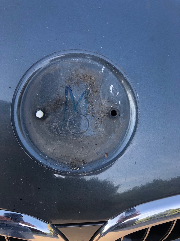

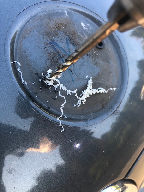

Needed to replace the BMW hood emblem on my bimmer. Okay no problem. Looked on line, ordered a part from www.partsgeek.com. Watched a Youtube vid on process... all set. The emblem arrived today, Aug 12th.

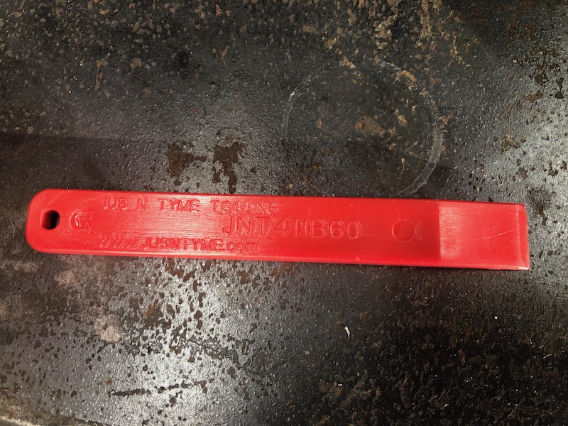

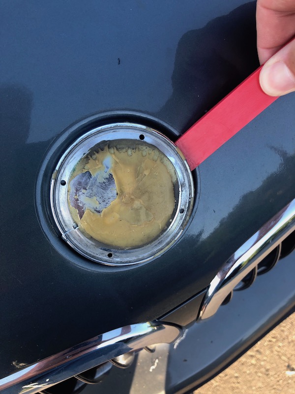

Easy fix... just use a wedge and protect the surface and pry around it and it should pop off. I even had a handy hard plastic wedge, JNT411B6. I do recommend a few of these non marring wedges for your shop.
and carefully worked around the old emblem base that had lost it's badge and of course... one of the pins breaks off! :smiley_aafz:

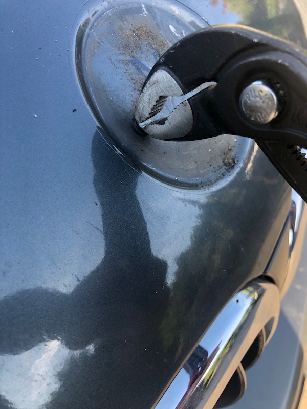

No biggie, grab my trusty Knipex pliers and pull on the little bit of pin left exposed... nope! That mushes off. :smiley_aafz:

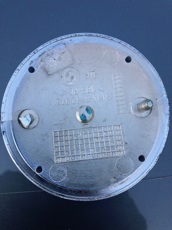

Okay, get the drill and use the other hole as a gage and drill out the plastic pin. Yeay... success! :dance1:
Go to pop in the beautiful new one... nope! Wrong size... WTH! Go around and look at the trunk emblem. Yep. :mur:

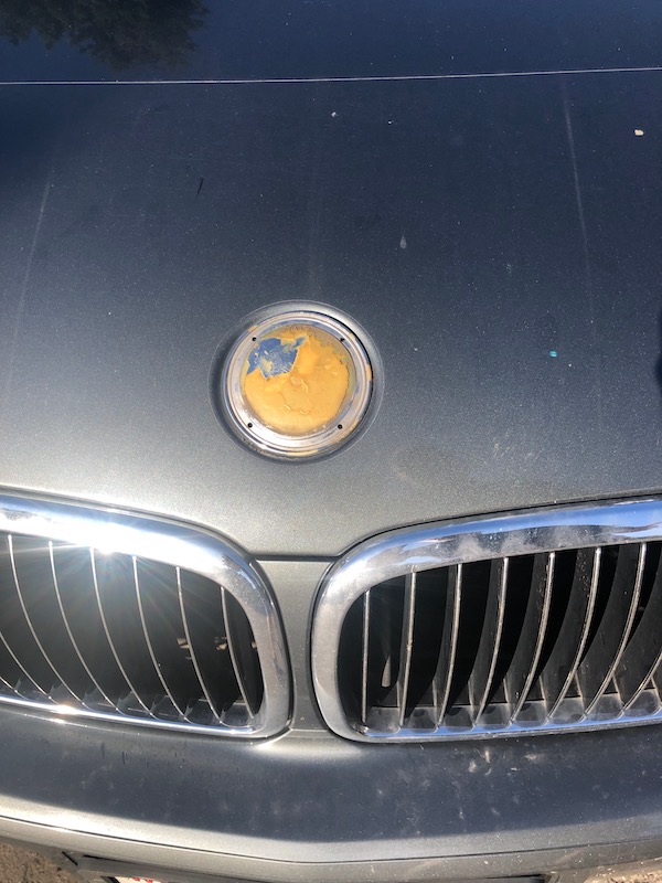

Now online to order the right one and get an RMA for the other so I can return on my dime. Stay tuned for the completed job started Aug 7th.
