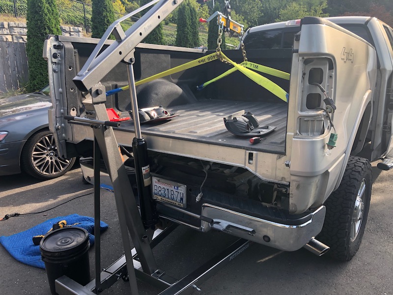

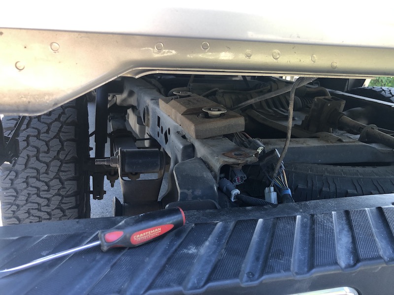

Okay... the lift! First try...

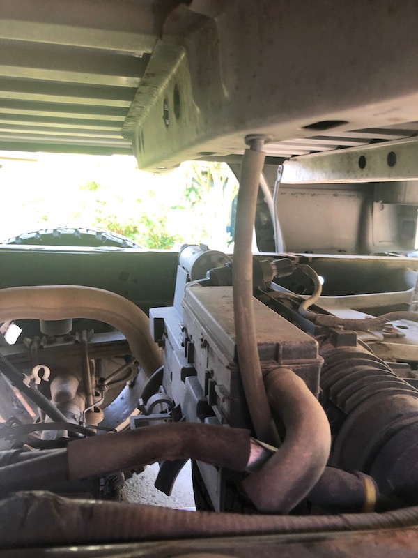

Far more stuff to unhook than I realized. Tail lights, gas fill spigot, backup sensors, license plate lights, a couple of vent hoses for who knows what...

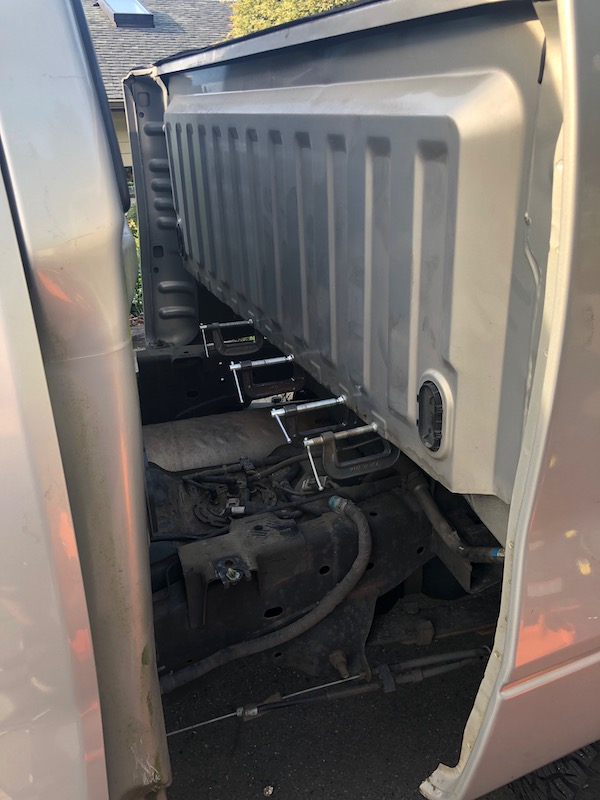

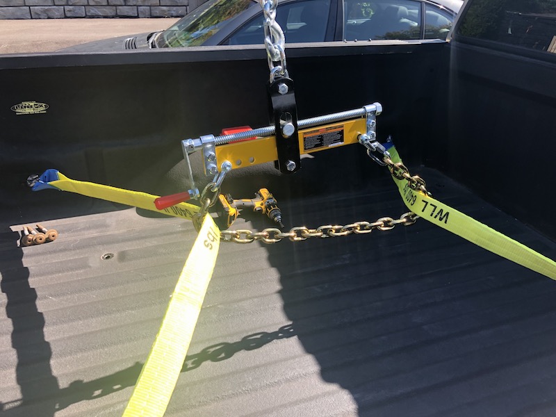

The lift, second try... had to get a little more slack and crane reach so I removed the tailgate.

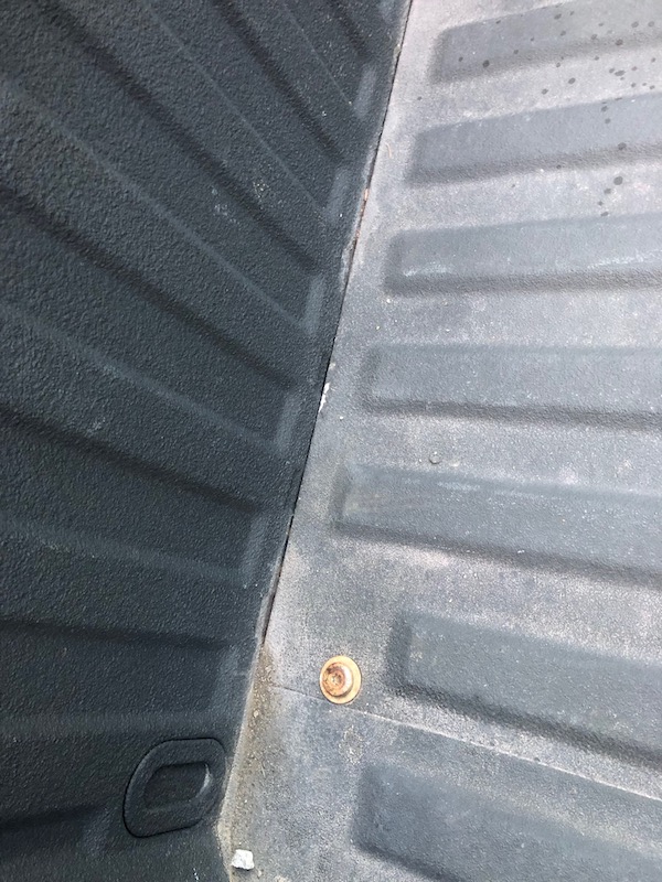

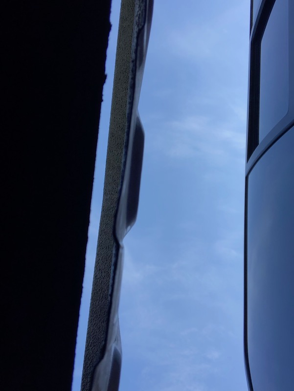

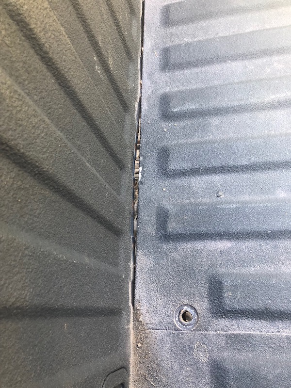

Here is the gap from above and below (blue sky) that I am trying to close...

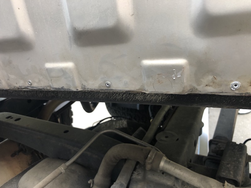

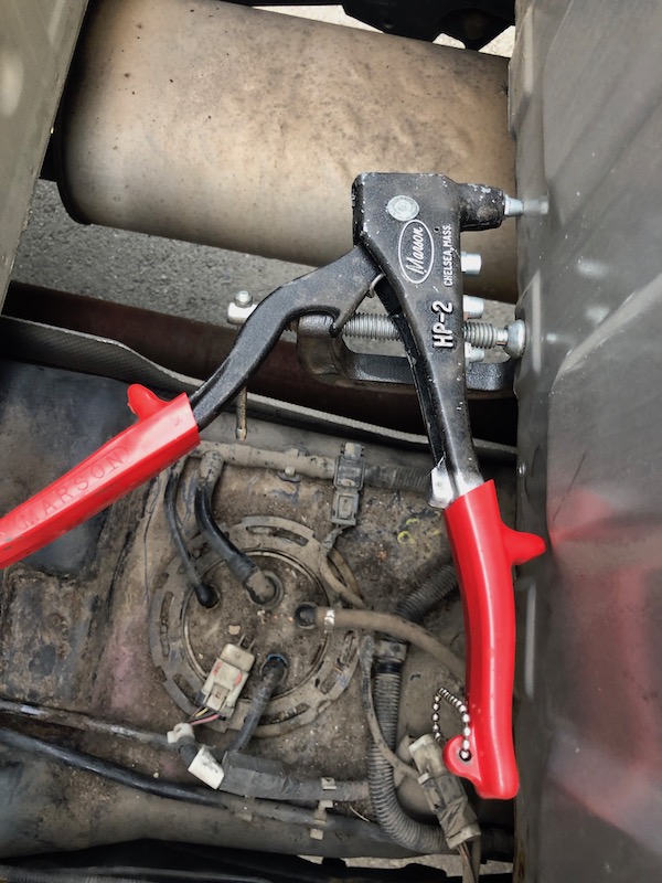

Clamped the flange. Drilled some 1/8in holes and installed a series of steel blind rivets with my old Marson rivet gun to close up the gap. Did take me awhile to locate that in my shop! :confused:
58743577283__C7545A41-0003-4CB7-A91F-6C4541E0F244.jpeg IMG_3111.jpeg IMG_3109.jpeg
Coached the bed back into place and the gap is pretty much gone!
Sure helps to have the right tools... along with my new HF 2T cherry picker w/ load leveler attachment, I used a pneumatic impact wrench with T-50 bit to remove the bed bolts (was nervous but they came out pretty easy) , cordless right angle drill for the tight space between the cab and bed, an impact driver, and a pop riveter.
